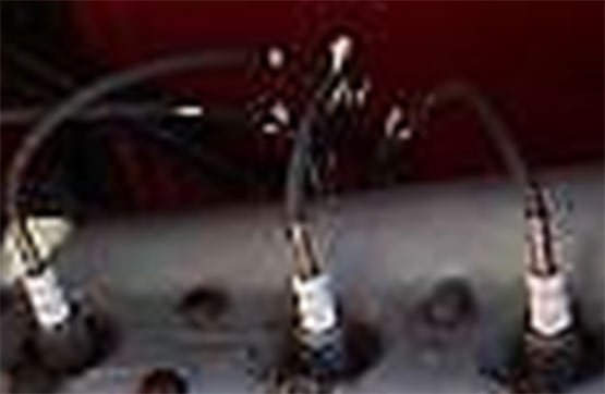

Below is the only photo of the Open Roadster engine area. It appears the spark plug wires are going to a central location such as a distributor or magneto rather than to the four individual contacts on the Ford style coil boxes.
Engine right side.jpg (30.49 KiB) Viewed 4676 times
(Yes - it is really low resolution -- but that is what they posted.)
Note after I saved the photo and zoomed in on it, I can now see that the wooden coil box on the dash of the Open Roadster and that it does have the insulators coming through the firewall. But there are no wires connected to them, so I missed that when I originally was looking at the e-bay listing.

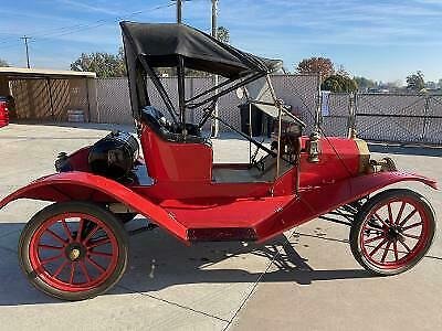

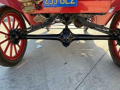

Eventually the e-bay listing will be gone. Below are a couple of the photos from that listing which again is located at: https://www.ebay.com/itm/1911-Ford-Mode ... SweAlf6mhN That way folks can see what we were talking about:
Right side.jpg (33.1 KiB) Viewed 4676 times
Rear axle.jpg (31.1 KiB) Viewed 4676 times
Right side rear.jpg (32.96 KiB) Viewed 4676 times
Respectfully submitted,
Hap l9l5 cut off

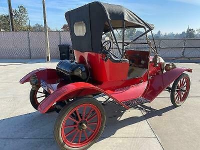

Post by Hap_Tucker » Tue Dec 29, 2020 3:38 pm
Right side front.jpg (32.58 KiB) Viewed 4676 times
Respectfully added,
Hap l9l5 cut off

Wires are going over the engine down the other side, so no 26/27 coil box. If you look real close, you can see the number pad just behind the timing gear casting. They could have taken clearer photos and used the enlargement feature, gee would have cost them a few more cents!
Re: Torpedo
Post by Rich Eagle » Tue Dec 29, 2020 3:51 pm
It looks to me like the spark plug wires are going to a distributor cap but I can't imagine what a distributor would be running off of in that location.

Re: Torpedo
Post by TrentB » Wed Dec 30, 2020 5:07 pm
From the rear view picture, I count 8 leaves on the spring. Both open and closed (torpedo) runabouts used 7 leaf rear springs.
Could be one of those cog belt or chain drive distributors mounted on that side or a magneto.

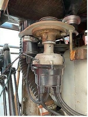

Enlarging the engine picture it look like it may have a Chevy II distributor laying on it’s side. It is driven with a pr. of 2pc., equal size gilmer drive gears, connected by a gilmer belt. The plug wires look like they are held in place by a stand, then routed to the distributor cap. I had one on my first speedster. It worked flawlessly.

Posts: 3863
Re: Torpedo
Post by Dollisdad » Tue Jan 05, 2021 1:35 am
Could be this setup.

Re: Torpedo
Post by Jonah D'Avella » Tue Jan 05, 2021 6:13 am
Here is one of the later pictures.
