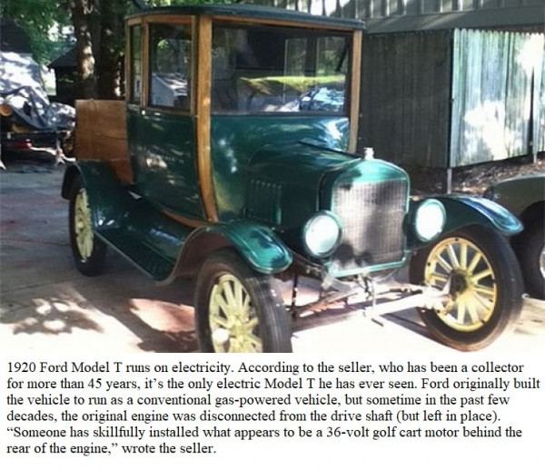

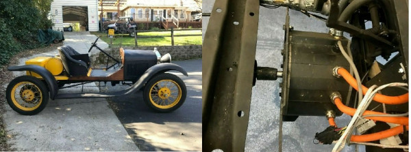

One was for sale on eBay claimed to be an original prototype https://www.ebay.com/motors/blog/green- ... d-model-t/ Speedster versions http://www.mtfca.com/discus/messages/11 ... 1291124879 This one is for sale http://topclassiccarsforsale.com/ford/6 ... ctric.html Not sure if this is available for purchase or if plans are available

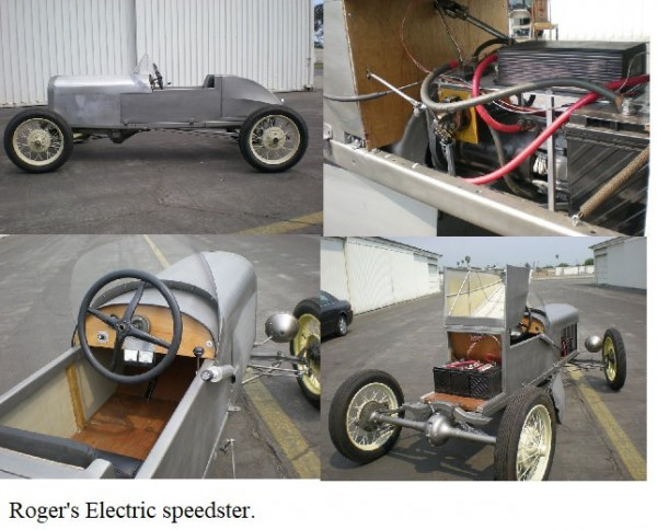

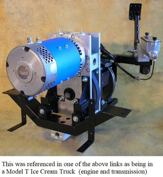

Above looks like just a gear reduction with a disk brake. Very cool and I love this stuff. My background is industrial motion control and I am very interested in building a electric conversion

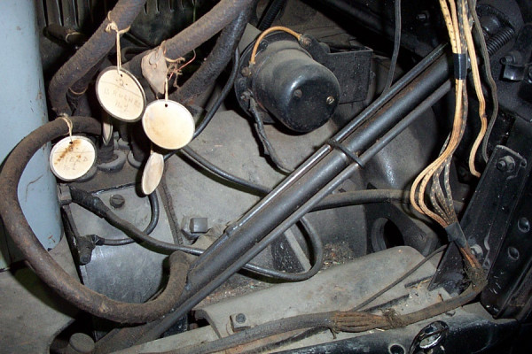

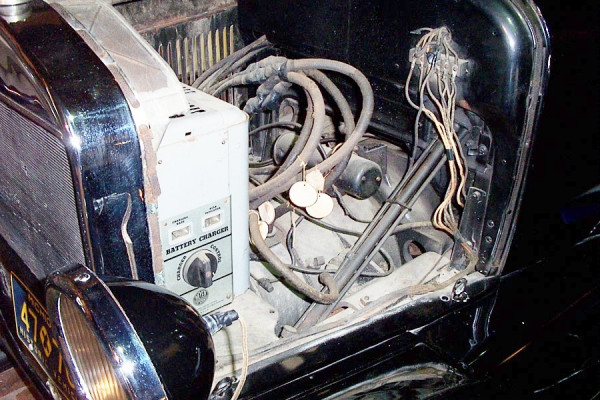

One of our Carbon Canyon Club members converted a mid 20's Runabout to full electric - was rather ingenious !

Does anyone have a link for the above picture? Or a link for more information on it? I am liking this a lot

That said, a self-contained unit like the one with the blue motor and the internal brake posted earlier in this thread might be a suitable alternative, although I would probably work harder at getting any pedals positioned like the originals. That one appears to include a socket for the wishbone, which makes it more of a “bolt-in” replacement.

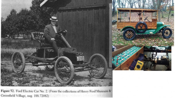

The man sitting in the electric Model T chassis with wire wheels in the third post from the top of this thread is Fred Allison.
He worked in the Ford Highland Park Plant Electrical Engineering Department and developed the Ford FA (Fred Allison) Starting and Lighting System introduced in the Model T in Late 1918.
Ron Patterson
