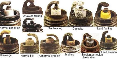

They don't look bad to me. I don't know if this spark plug info helps any.
I remember charts like that in the 60s. They didn't help me much. Someone who sees these things all the time under varying conditions might know.
