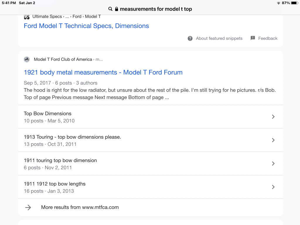

If he knows all that, he doesn’t need a pattern. There are key measurements on line.

Dropacent, were can i find the key measurements?

Cmon, Jonah. I found them in 2 seconds and I’m a computer illiterate

I apologize for my incompetence, I was just wondering if you knew of any specific websites. I am limited in in the amount that I am allowed to web search.

Use the search function at the top of the page. Much faster than waiting here for an answer. Sometimes you have to try different topics to get your answer. Sometimes you can use google and just include MTFCA or Model T ford in your search. You are not incompetant. You are just learning and remember that no question is a dumb question. We all have to learn somehow.

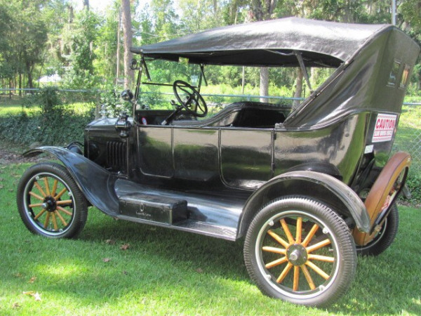

I could be wrong but I don’t think you will be able to find the 1927 touring top pattern in the form you need for your friend to use to make the top. That is, the individual pieces necessary to create the entire top from the waterproof top material you purchase. I searched the web using several different descriptions using “mtfca” in the search and, if I could have found a pattern, I would have posted it here for you. Sorry. Maybe someone else will have better luck, but I still think purchasing a kit from Classtique will be cheaper and better in the long run, but I commend you for your faith and perseverance. Jim Patrick

I looked in the MTFCA photo gallery and found two good pictures taken from the side: the ‘25 T roadster was posted by Dan Treace and the ‘26 T roadster was posted by George N Lake Ozark. Comparing the two pictures might give you a idea of the differences. If, when I post them on this thread, they are too small to see details, you can go directly to the gallery and click onto the pictures to zoom in and have a close up look. Jim Patrick
