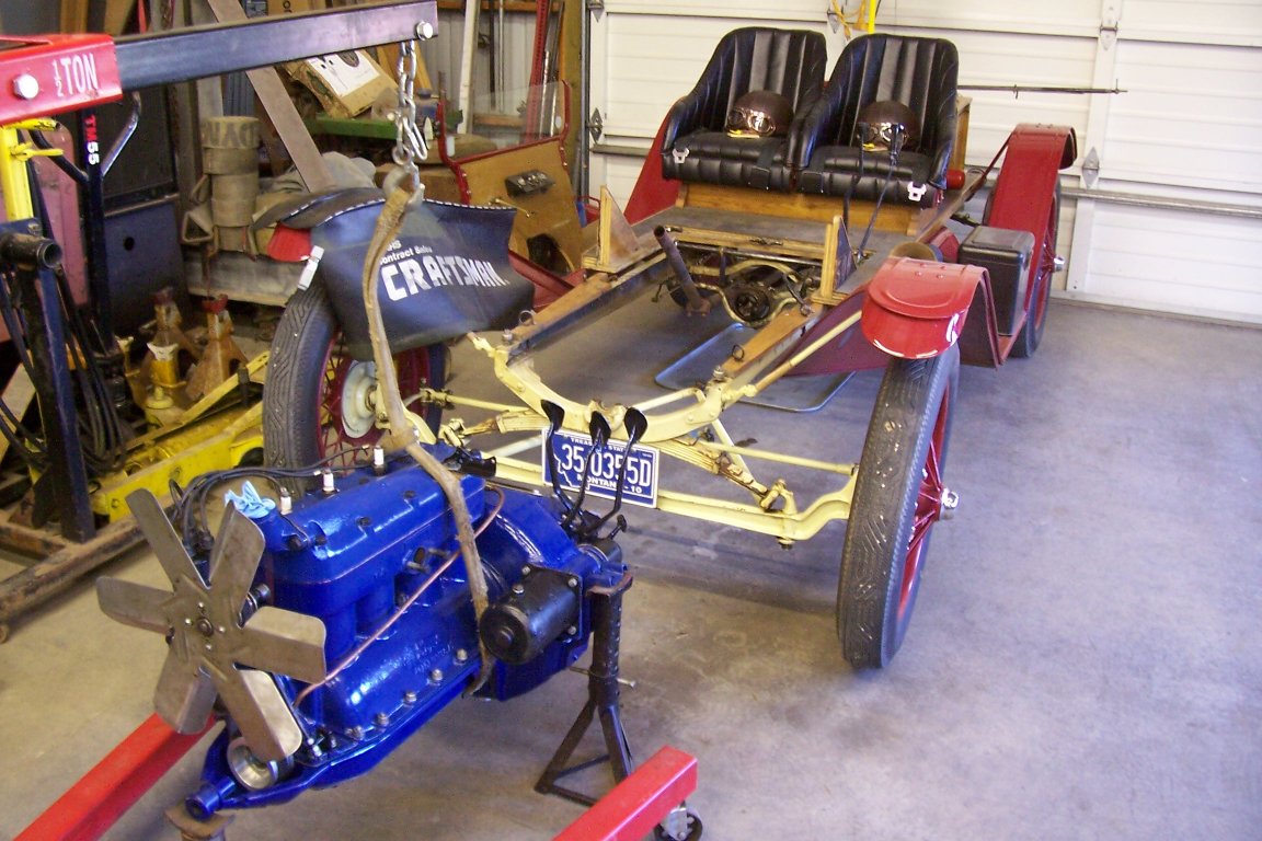

To lift a Model T Engine , I use this :
Toon

Neat ideas, I use the plug lifting eyes but dislike the fact that they dont lift level. You have twice the thread engagement in a spark plug hole than a head bolt. I would make sure they are tight in a aluminum head. Pat the sling idea looks pretty versatile ( thats a neat fan) and I would like to know the offset Anthonie used to balance side to side. Tim which bolts do you use with the tipper? I find the tipper works best with three or four mountings otherwise tipping front to back throws the side to side off. but have never used mine on a T engine. They do work good on those funny overhead V configured engines. I loaned mine out once and it came back with the crank missing and a socket welded to it so you can use a cordless drill to tip it. Sometimes when you loan tools they come back better than they where, sometimes well you know!

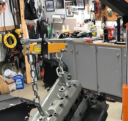

I use a coupe of long bolts into the block with a load equalizer. By turning the crank on the equalizer, I can get the engine just right to angle it in.
Hoist equalizer 2.jpg (67.84 KiB) Viewed 3808 times
