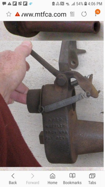

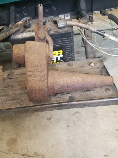

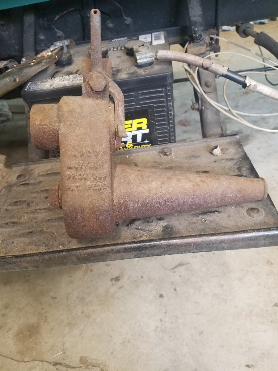

This is mine that Im installing on the TT.

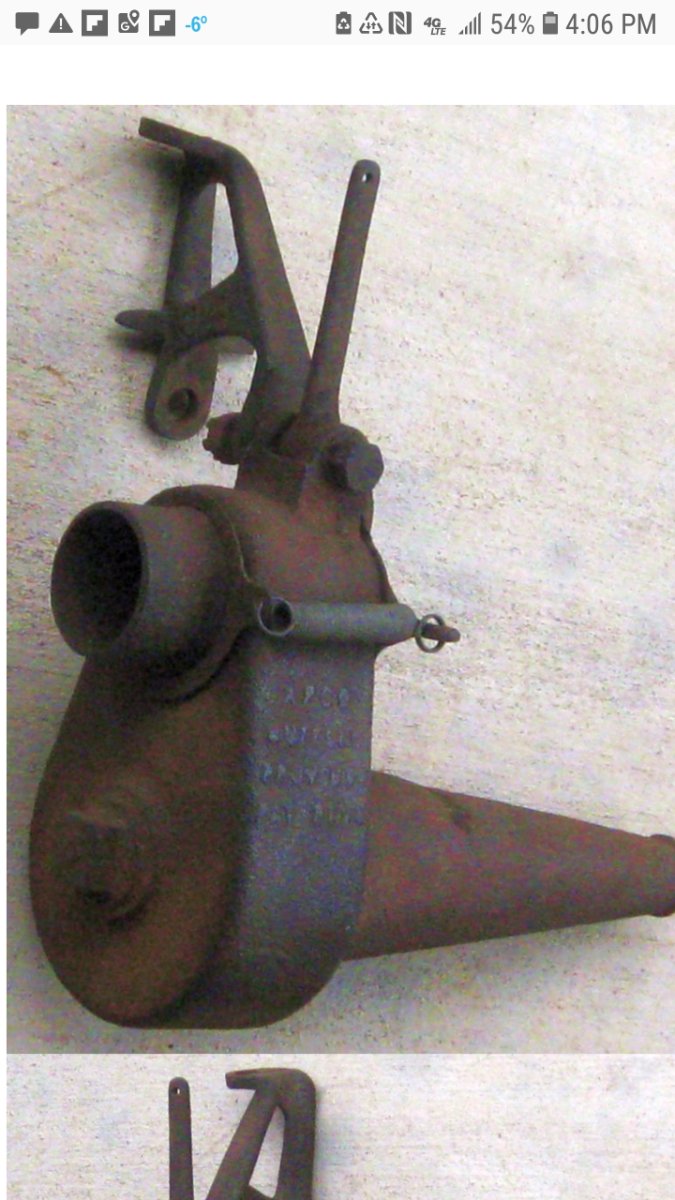

The last two photos I borrowed from forum. Jay is a much better photographer than I.
I have a foot cut out for it and need to see mounting locations and linkage setup. Any help would be great. Thanks Dallas

certainly appears to mount where the front muffler bracket would mount. Cutouts typically operated with a cable or chain like a window sash chain, through necessary pulleys.

Thanks Scott, I was thinking cable or chain. Not sure where to mount the foot peddle . I guess a hook on the chain could be removed easy when taking out floor boards for service.
