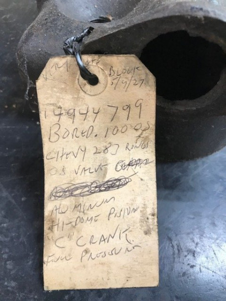

Here's one at .100 over.

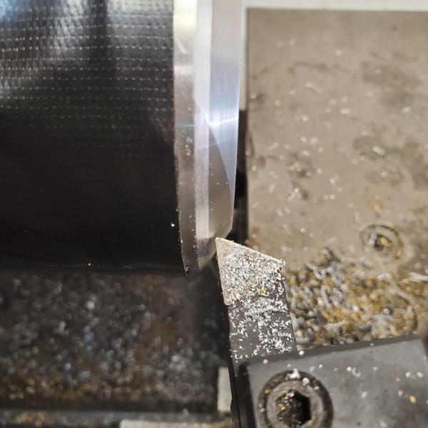

Just to continue the discussion about pistons hitting the head, I have a .080 os bore and my pistons were hitting the Ricardo head I installed. Rather than remove stock from the head, I beveled the alum pistons. Worked great.
