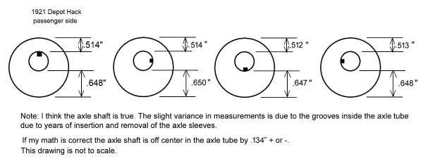

Does anybody know the limits on when an axle housing is bent enough to warrant attempting to straighten it? My axle shaft is off-center in the housing by .134”. This was a new, modern axle shaft that was installed in 2017. The shaft itself does not appear to be bent. The Hyatt bearing is good, within tolerance and no play, and the shaft itself has no end-play. What do you think?

Bill, the difference between your measurements is .134" but the shaft is only half that amount or .067" from center. Not that this answers your question of how much is too much.

Hold on. Does that measurement really mean anything? Doesn’t the axle not sit centered in the housing without the outer bearing to keep it there? What am I missing?

Is your drawing really correct in that it shows the axle sitting above the housing centerline? A bent housing would typically cause the axel to sit below the housing centerline.
Also, it appears that your inner seal is installed as you take your measurement. At some amount of deflection, the seal will begin to support the axle, giving an erroneous sense of just how much offset there really is. I usually check for any offset/deflection with the inner seal removed. Since there's always a bit of "droop" anyway, due to gravity, I lift the axel until I get some fair resistance, note how it's offset from the bore, then compare that to the offset when the axel is unsupported, (i.e. drooped). If the "up" & "down" offsets are the same, the housing is not bent. If they differ, then the difference suggests how much the housing is bent.
As someone else suggested, if you can insert the Hyatt bearing without using undue force to raise the axel enough to do so, then you're probably in good shape.

Jerry- the drawing shows the centerline of the axle tube is actually below the center of the shaft. I agree that the inside seal might be supporting (I hope!!) the shaft and maybe if I remove the seal it will let the axle drop approx 1/16" (could I be that lucky?).
In the morning, I'll go to my shop and pull the seal, and re-measure. My fingers will be crossed.

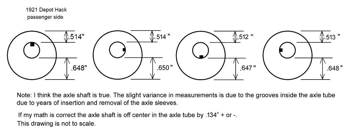

Meanwhile, I have some new numbers. This time I took the earlier suggestion that I should rotate the axle shaft and remeasure, to see if the shaft might be bent rather than the tube.
4 views of the axle shaft 90 degrees apart

OK. I removed the inner, modern cone shaped rubber seal. Luck did not go my way. Instead of the axle moving down toward the center as expected, the axle shaft lifted slightly to the top of the axle housing tube. The clearance at the top changed from .514 to .466.

The new measurements are too far off to ignore. I'd definitely find the cause and correct.

While nothing is impossible, I would think it's fairly rare to have the axel tube bent downwards at its outer end, causing the shaft to sit above its centerline. I would think that housings get bent due to the spring bottoming out and smacking the center of the axel housing, making the whole assembly "swaybacked". What you're describing is the opposite, with the whole assembly being arched upward. Not personally having had a housing bent to any noticeable extent, perhaps my understanding of how the bend commonly occurs is flawed. Maybe others can offer their findings.
How much force is needed to push the axel back on center? Can it be done easily by hand?
As Richard suggests, it's probably worth looking into further...

The axle housing should be straightened. I previously said don't worry about it but I was thinking .0067 inch instead if .067 in. off center. The hazards of not checking and rechecking. Art Mirtes

This morning John Z and I dis-assembled the axle. As stated earlier- it appears that the RH half of the axle housing may be slightly bent down, towards the road.
The 1st photo shows the female end of the axle tube where the axle bearing sleeve is inserted. It is extremely grooved with highs and lows from end to end. The photo shows the grooves AFTER we honed it the smooth the high points a bit. After honing for about 30 seconds, then inserting the sleeve, we both immediately noticed that the gap in the sleeve had spread some. We then inserted axle shaft and then put the Hyatt bearing onto the shaft and easily slid the bearing into the sleeve. Before the honing, a little tapping was required to insert the bearing. There was no play between the shaft and the bearing. It felt good.
Photo 2 shows a straight edge on the bottom side of the tube. There is a very slight amount of daylight visible regardless if you look at the top or bottom.
Photo 3 shows a defect in the top of the axle. It appears to be a weld that someone attempted to grind smooth, but missed their goal. It now appears possible that the axle may have been involved in a wreck at some time.
This is the axle tube where the sleeve inserts. It was very &quot;grooved&quot;.
This is the axle tube where the sleeve inserts. It was very "grooved".
A small amount of daylight showing under my straight edge.
It looks like a blob of weld, but it could be a crack. No oil leakage, though.
Posts: 4394
Re: Does my rear axle housing need to be straightened?
Post by Jerry VanOoteghem » Mon Jan 04, 2021 8:55 pm
Some folks straighten axle tubes by welding on one side. The thought being, that the weld will cause the metal to shrink on that side, thereby pulling the tube straight. Not sure if the weld you show was done with that intent or not.
The rough bore in the tube is pretty much normal. It's a nice fit when the bearing requires a small shove, (usually by hand), when inserting it.
To get a real idea of how straight your tubes are, bolt the two halves back together, then set the assembly on 2 large "V" blocks. Rotate the axle housing on the "V" blocks and look for runout. These don't have to be precision "V" blocks. Anything you can make out of wood, that's solid and large enough will do. Place the blocks as close to the backing plates as possible, then rotate. Keep in mind, the mating faces of the differential housing can also be warped.
