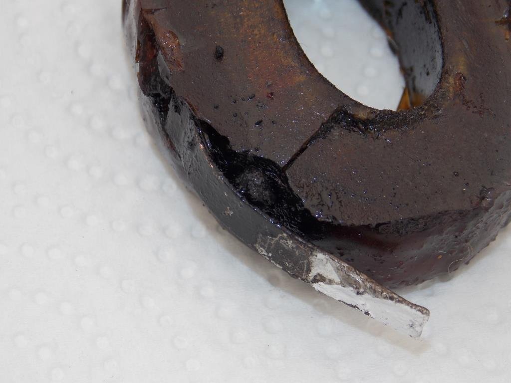

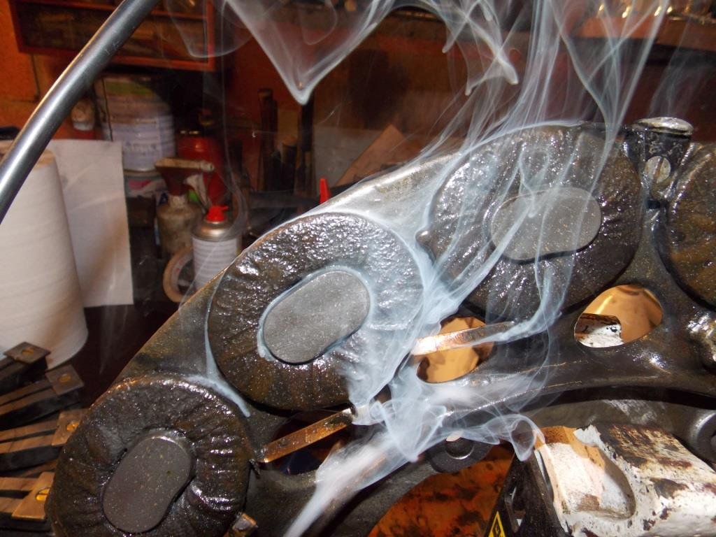

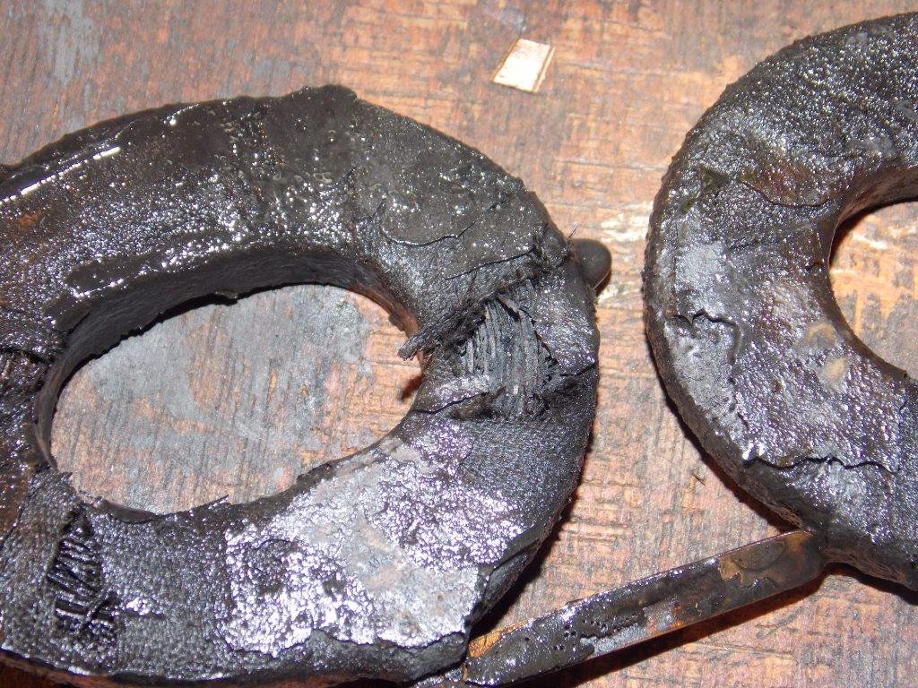

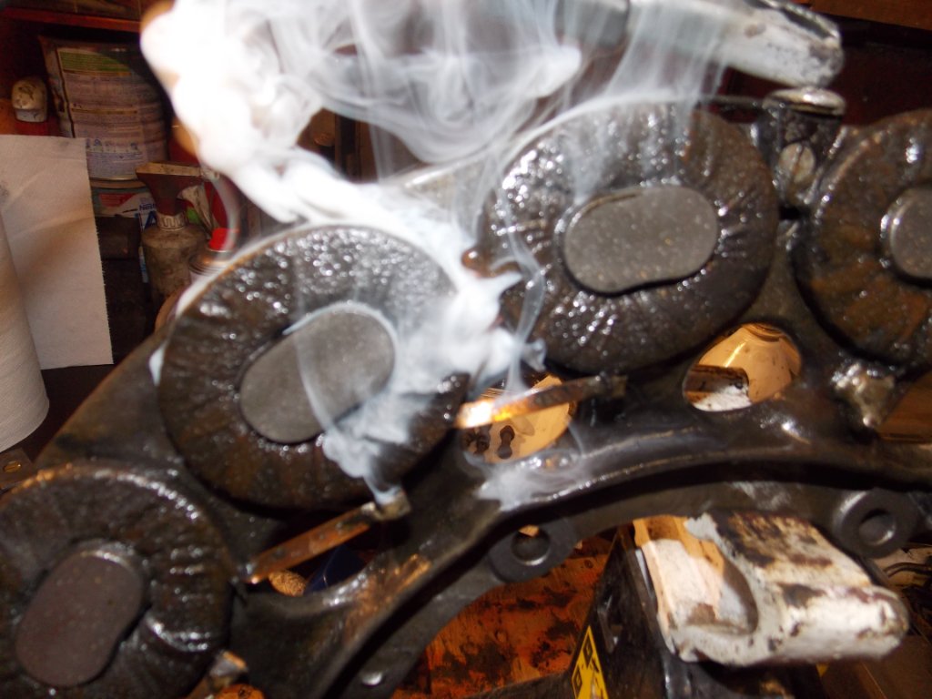

The photos are from a good looking coil ring that I tested as shown in the other post. During the test, in front of one coil the compass needle set parallel with the coil not pointing North or South. As soon as I shorted the coil ring (12V over the loop without the 21W light) at that coil a lot of smoke came with some flames.
The good looking coil loop was just good for a rebuild.
In that coil ring there were no washers between the coils and the frame.
On the photos you can see the "bad " coil and the damage.
So YES this shield is needed.

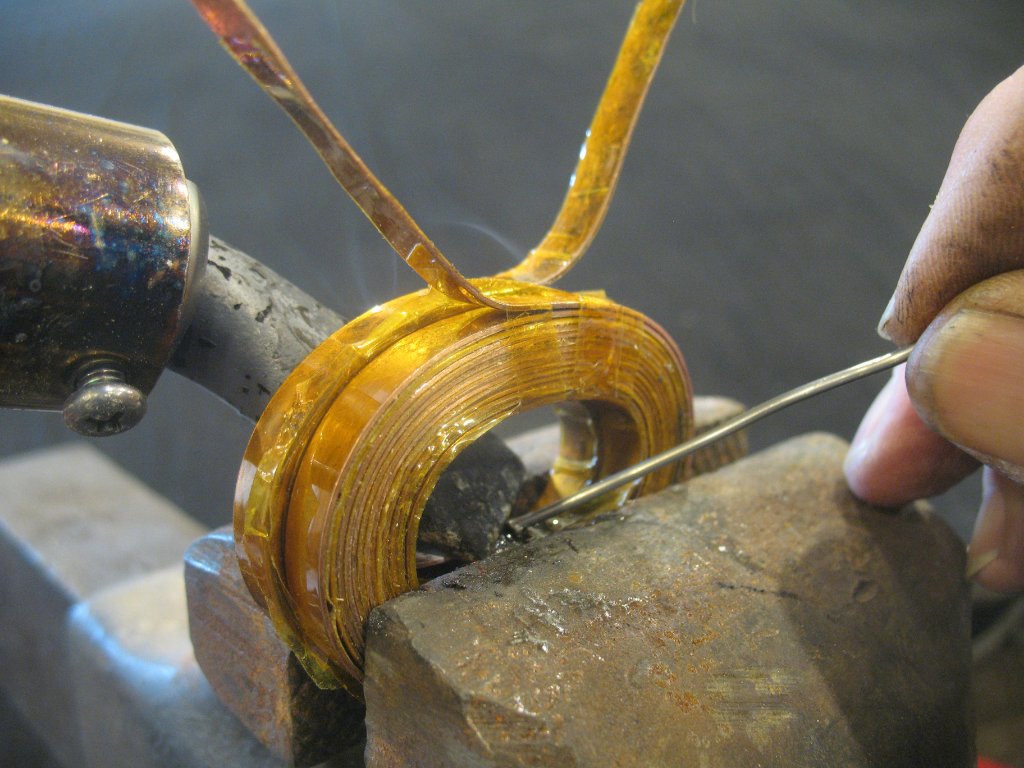

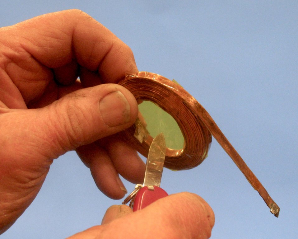

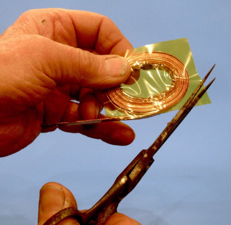

Insulation between coil halves: Yes, I have that.
Each half of the double coil has a layer of Kapton™ so that when the two halves are joined they have two layers of insulation between them.
The only place current can go from one half to the other is where the inside ends are soldered together.
Each double coil is wrapped in ½" fiberglass tape and coated with clear insulating varnish.

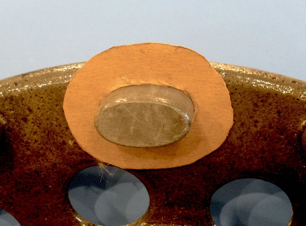

I don't understand why the cardboard is needed between the coil and the flat surface of the ring and not around the core that's part of the ring, but I'll go ahead and install it. The cardboard isn't thick enough to put the coils past the ends of the cores. The coils will be safely out of the .025" to .040" mag gap.

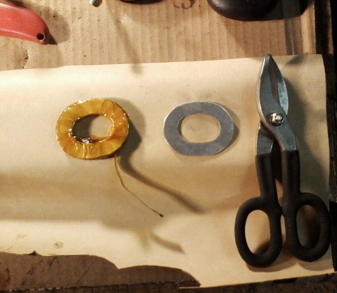

I've only tried this once but I used two paper insulators, one on each side, inside the wraparound tape, not external.
First I cut an aluminum template and then made insulators in mass from a gasket roll. Eventually, they were covered in red varnish.

Vern, how did you cut these? They look neater than mine.
varmint
Posts: 1043
First Name: Vernon
Last Name: Worley
Location: New Orleans, LA
Re: Mag coil insulators: Yea or nay? Why?
Post by varmint » Fri Jan 08, 2021 10:46 pm
Steve,
Found these pics to help refresh my memory.
I literally cut the aluminum template from scrap and ground the edge smooth.
Traced around it and cut with plain utility blade and cheap but sharp snips.

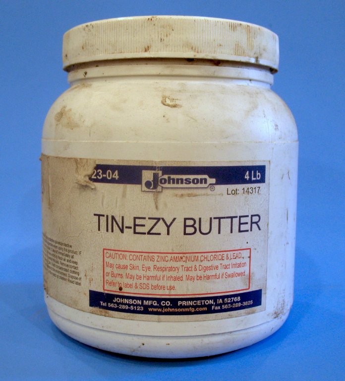

Can you elaborate on what exactly "tinning butter" is?
Here you go, Jerry.
I bought it to use with body solder and mistakenly figured it would be OK for soldering mag coils, not realizing that it's corrosive to copper. It's not OK for that, as our friend explains. I mentioned it here viewtopic.php?f=2&t=18219, and I'm glad I did, or I would have put the car together with that stuff eating away at those coils.
