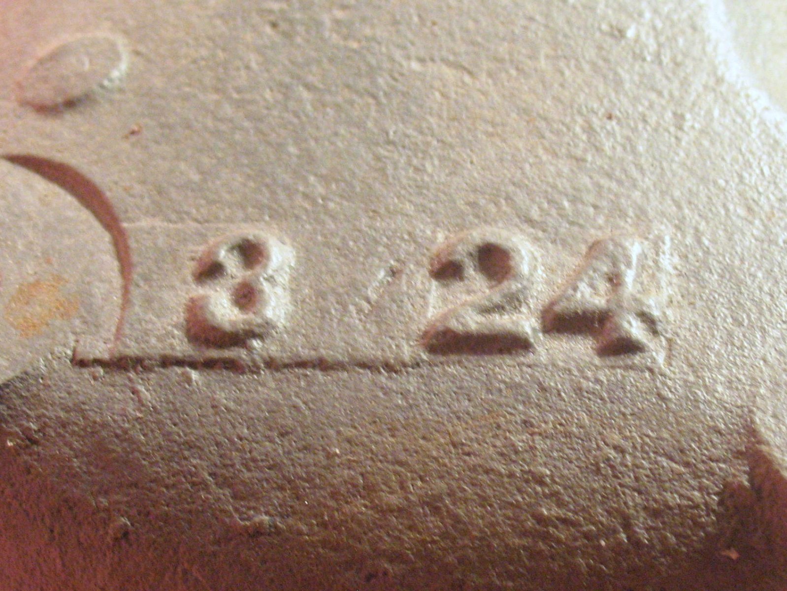

From what I see in Gail Rodda's Volume 2, this low head would be 1913-1917. Am I reading it correctly? Is there any way to pin it down closer than that?
I gather this means March 24, with no reference to the year.
Has anybody ever deciphered the marks on the water outlet? Some are numbers and some are letters.

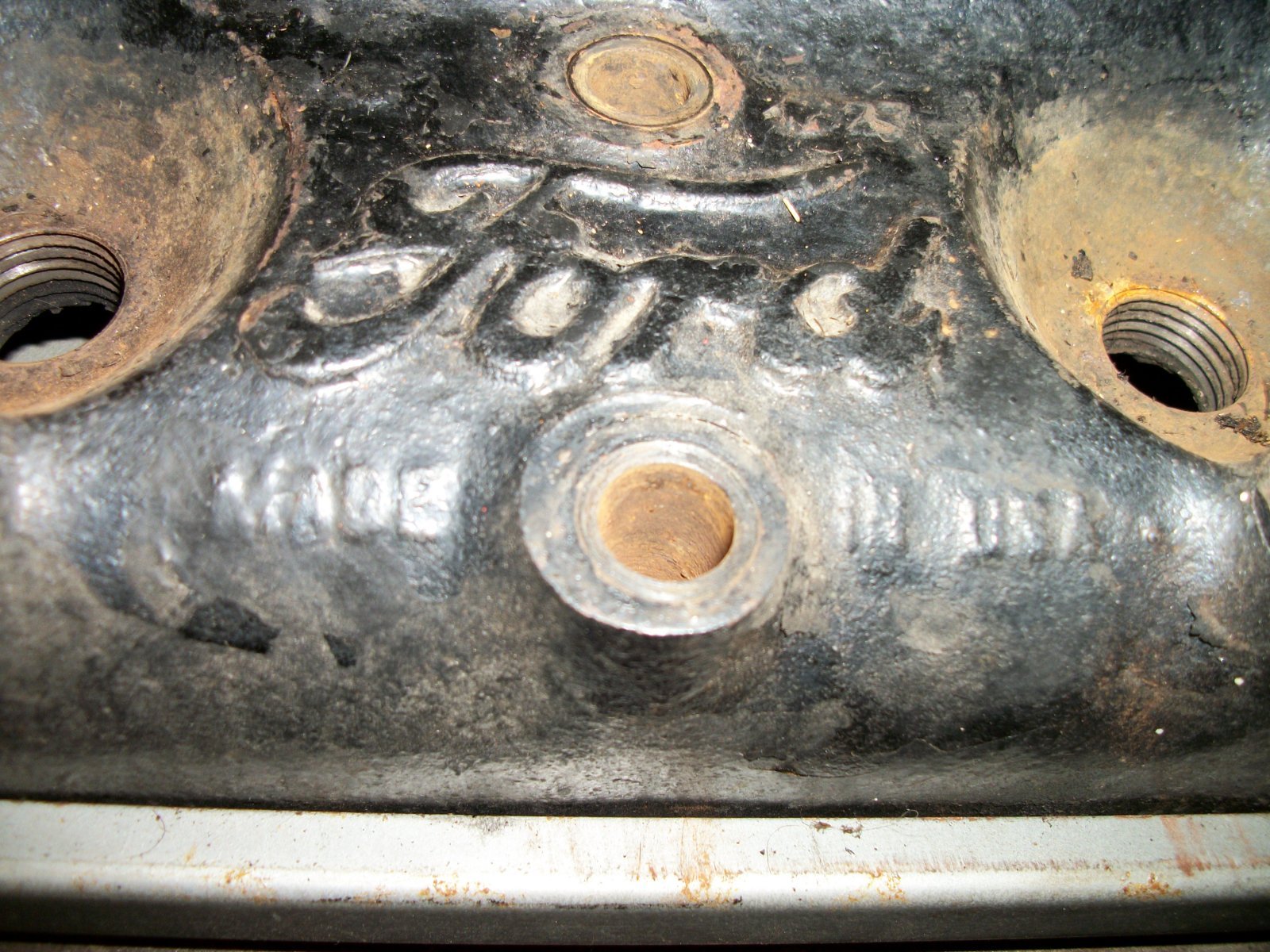

Colin Mavins
- Posts: 388
- First Name: Colin
- Last Name: Mavins
- Location: Winnipeg Canada
Re: Low head questions
This is the original low head on my Sept 1912 Canadian touring , the casting date is above the ford and split by the head bolt one part on each side.As it sits the cast date is not readable. In the summer when the car is out in the sunlight I will have try and read it maybe strip the paint. Cheers Colin
