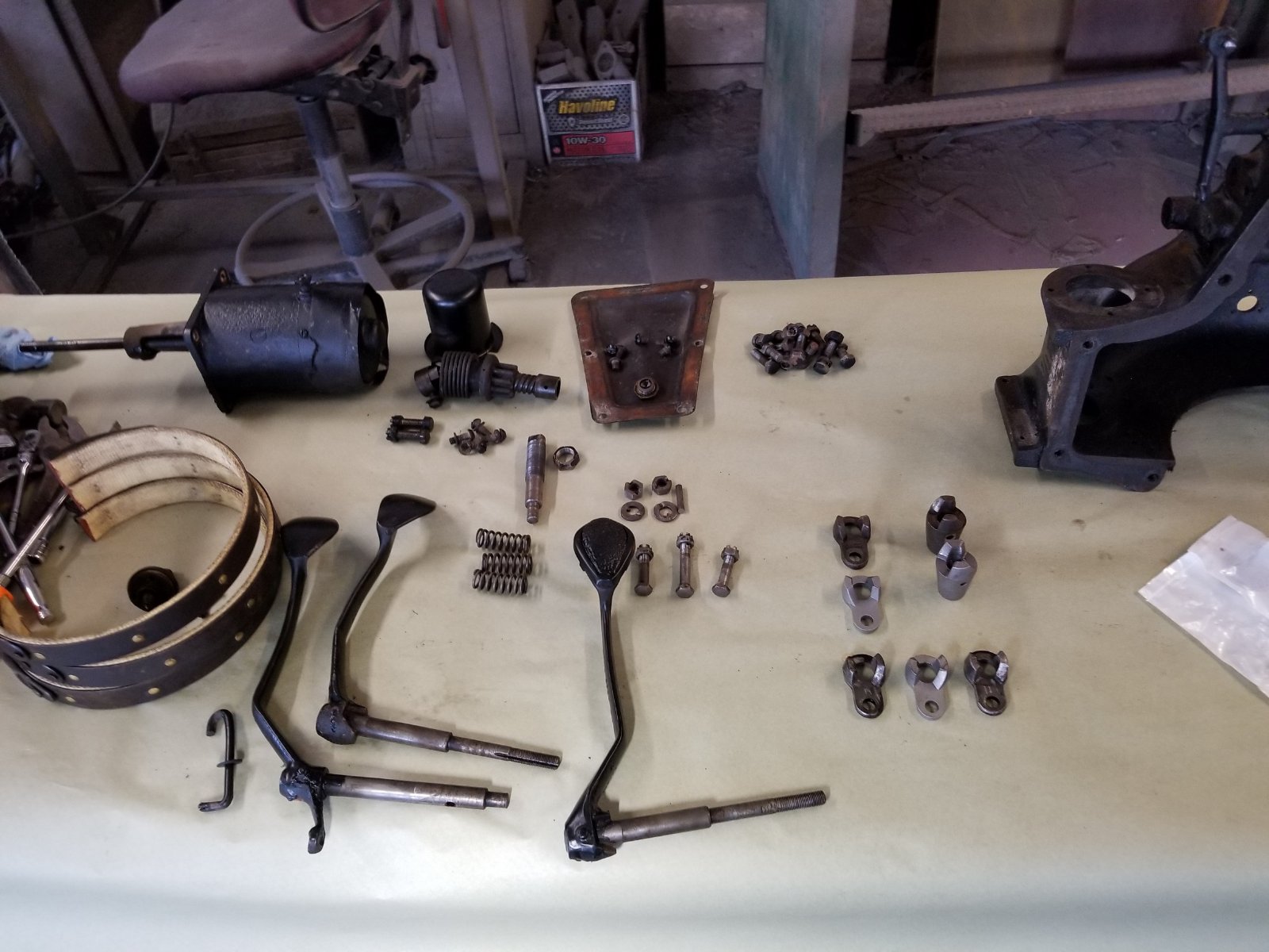

Was hoping to just replace clutch shaft. While disassembling today it was clear the reverse and brake shaft needed replacement. The worn out bands led to over adjustment. The band ears wore on shaft threads. I'm don't believe the brakes were working when it was parked back in the 70's. If they were working, they must have made a racket. Some genius installed the bands with steel rivets and the band material was gone.
Got some good photos today but I'm stupid and cannot figure out how to post. Sized them down to 1meg.

Post by lmitch » Sat Mar 02, 2019 10:06 pm
[image][/image]
[image][/image]

lmitch wrote:
Sat Mar 02, 2019 10:05 pm
Many years ago it was reported that some band material sets were being sold with brass “colored” rivets.
Unless one tested them out with a magnet they could easily be installed by mistake. Someone with experience would feel the difference bending the ears out but for someone who had never installed band linings before the switch could easily be missed.

Post by Scott_Conger » Sat Mar 02, 2019 10:27 pm
Take a few minutes now and straighten and align the pedals, too. You can work them cold just fine. The reverse pedal especially looks a little wonky unless the photo lies.

Post by lmitch » Sun Mar 03, 2019 12:21 am
You are correct. The reverse and clutch pedal need adjustment.

I agree with all the above. Also you might find that one or more pedals, usually the brake and low can be bent from pushing hard on them. It is impossible to get the right adjustment without straightening them out and if needed, weld and grind the cam portion of the pedal as Mark says.
