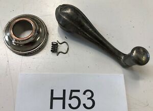

I think the handle change came when Ford switched from wood frames doors to the steel frame sometime in 25. The later ones I have seen have the clip on the back of the handle that is accessed by pushing in the cover behind the handle and exposing the handle clip so you can push it off. It’s kind of hard to push in as I remember but the clip is there. At least on the one I’ve seen. Some had a pin I think but not sure.

Post by jiminbartow » Wed Jan 20, 2021 11:58 am
I remember those John. Now that you mention it, when I first bought my 1926 coupe in 1970, both window regulator handles were badly corroded pot metal and broken off. They were secured by spring clips as shown in the photo however, there was no little spring as the photo shows, that I can recall. There is a special tool to push the clip out, but it can just as easily be removed by pushing the clip out or prying it off with a small standard blade screwdriver. I replaced the crank handles with two nice nickel plated repros secured by set screws. Jim Patrick
