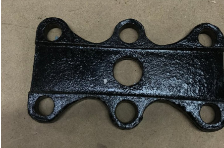

What is this for?
Posts: 6609
What is this for?
Post by TRDxB2 » Tue Jan 19, 2021 7:50 pm
Spacing of the corner holes is the same is early front spring clip
John Warren
Posts: 1071
Last Name: Warren
Location: Henderson, Nevada
Re: What is this for?
Post by John Warren » Tue Jan 19, 2021 8:17 pm
I would say it is a front spring clamp plate that can be used for early and late cars
Posts: 7332
Post by Allan » Tue Jan 19, 2021 9:02 pm
It could well be from a horse drawn light jinker.
Posts: 5622
Post by RajoRacer » Tue Jan 19, 2021 10:37 pm
It was an accessory front spring clamp bar - apparently, the earlier double u-bolt bracket was a "better idea" !

jiminbartow
Posts: 2489
Last Name: Patrick
Location: Bartow, FL
Post by jiminbartow » Tue Jan 19, 2021 11:54 pm
Dan, you are a virtual cornucopia of knowledge.
I thought it might be used to lower the front end by flattening out the arc of the front spring. Maybe a lower front end was thought to be more trendy and sporty. Jim Patrick

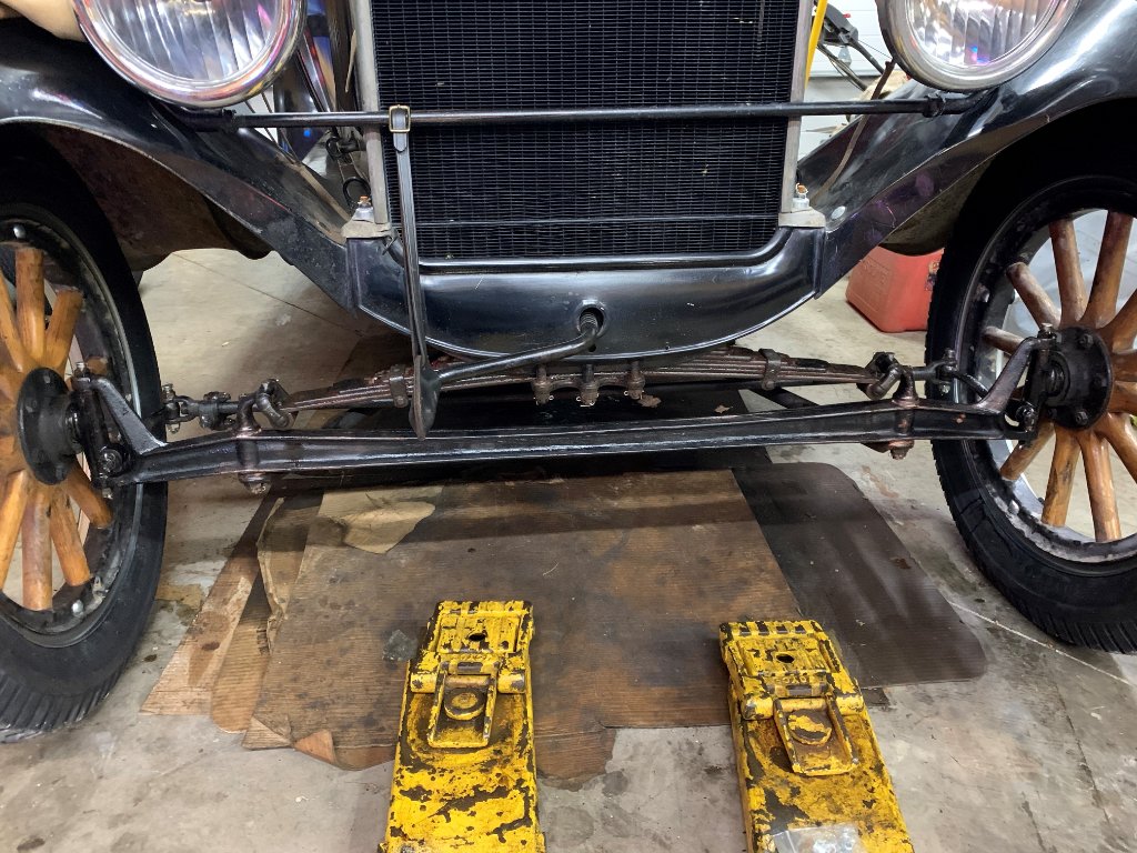

Post by Scott C. » Wed Jan 20, 2021 1:35 am
My 26 Coupe has one on it.
