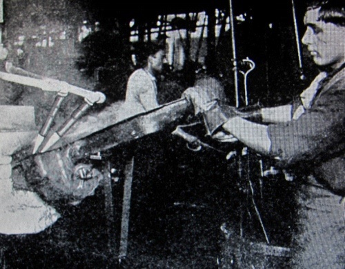

Re: Remove brazed on parts
John
This is how Ford did the pan brazing in 1915, of course the process must have changed over the years for higher production rates
