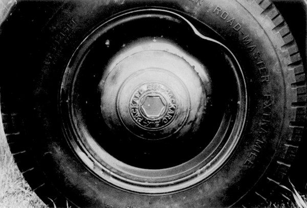

- Posts: 7411
Re: TT rear wheel woes
There are shops in the business of fixing bent wheels. Maybe with a google search you can find a shop to fix your rim.
The shop that straightened this wheel for me made it good as new.
- Posts: 7274
Steve, your Packhard rim was a prime candidate for re-rolling. that is the simplest form of rim straightening, and is most satisfactory usually. I wonder if the same can be said for straightening the variety of rim profiles used on various makes and configurations of truck wheels. I doubt They would be able to re-roll a wooden wheel felloe unless the wheel was stripped down, and then they would have to have/make rollers to suit the profile of the metalwork.
