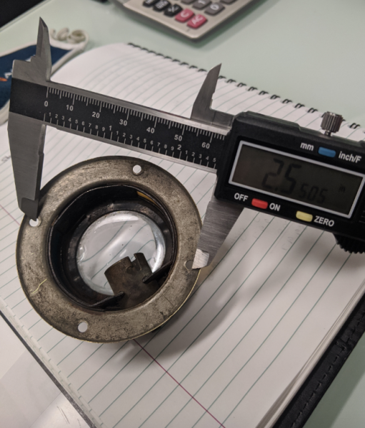

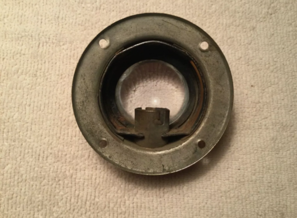

I recently acquired a motometer glo-light and am curious on what size motometer would this accessory fit. I would like to purchase a motometer and add to my T roadster build.
I measured between bolt holes and got an measurement of 2.55 between center holes. Measuring at a criss cross pattern. The overall outside diameter of the glo-meter is roughly around 2.88.

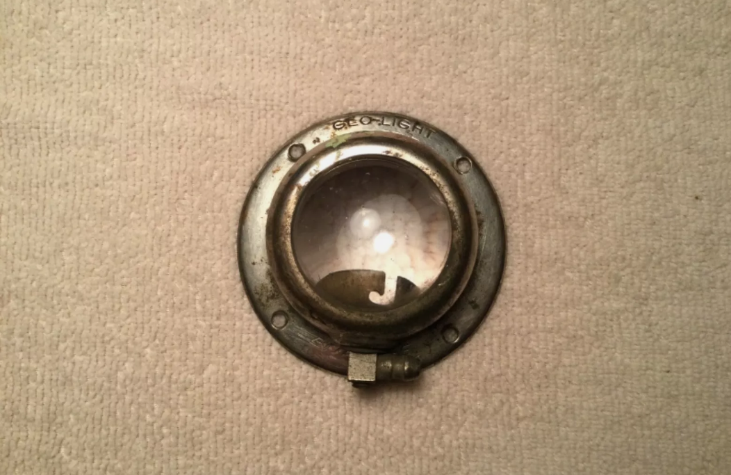

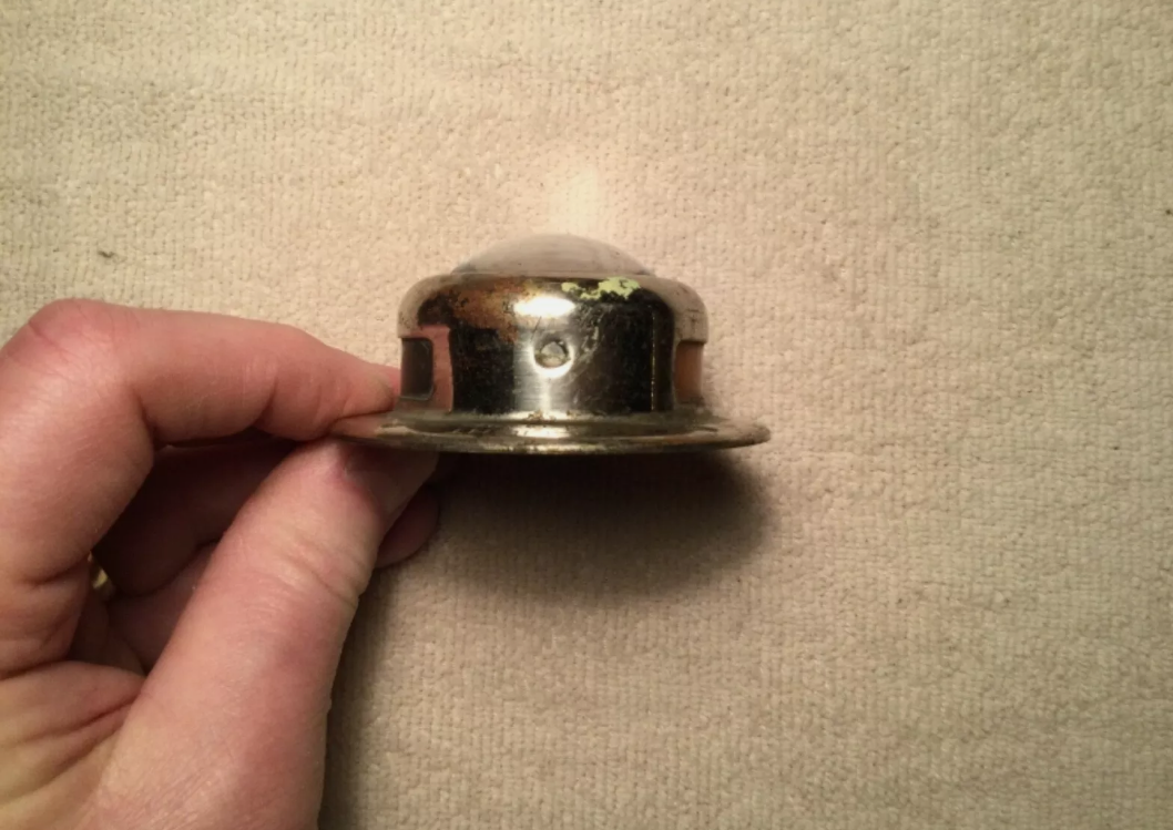

Re: Motometer Glo-Light what size would it fit
Here is one mounted on a junior meter. The light unit is from the 1920s. The junior meter if from the 1950s and is a working meter. It is for sale for $108 post paid. I will list it in the for sale column if no one buys it from here.

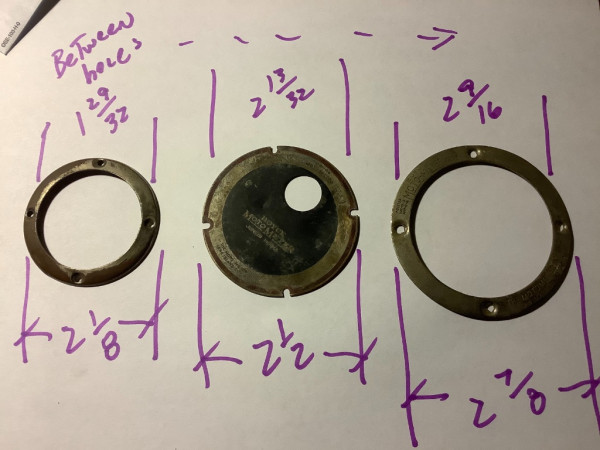

This may help. The middle one is marked “junior”
