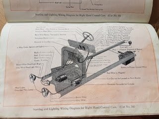

Copy of Self-starter on Right Hand Drive Motor - 500dpi - Ford Times May 1920.jpg

Post by Mark Gregush » Wed Jan 27, 2021 9:40 pm

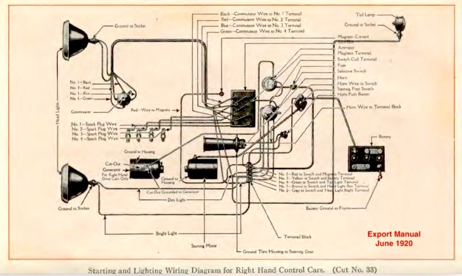

This older post has photo of wiring diagram for on Aug 1920 Canada Export manual.
http://www.mtfca.com/discus/messages/70 ... 1512380307
Posts: 4113
Re: URGENT! WIRING ON EARLY ELECTRIC-START T - OR TRYING TO CONTACT WARWICK LANDY (OR SOMEONE WITH CANADIAN SERVICE MAN
Post by DanTreace » Wed Jan 27, 2021 9:56 pm
Found the diagram. Here is scan from the Export Manual.
Complete Overseas 1920 Manual at this link:
http://www.cimorelli.com/mtdl/1920/1920comaug.pdf
Click on image to enlarge.

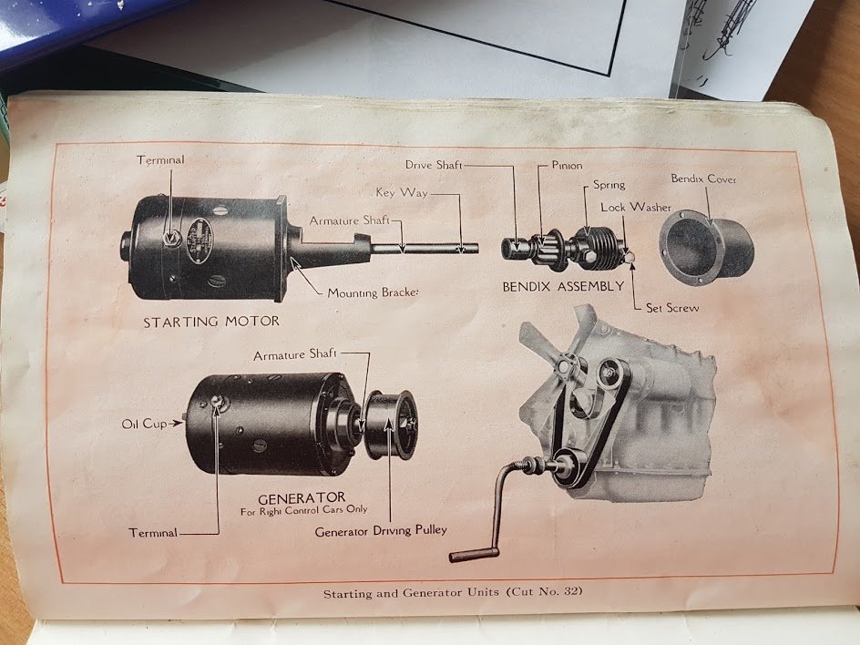

Hi John, It is rare that I miss a forum post and one that mentions my name, but I did miss it! however, your friend David Carver alerted me this post and I will do what I can to help out. Her are some of the RHD generator pics. i may need to scan for from my Canadian manual If I cant find them in my files.
generator picture.jpg (23.28 KiB) Viewed 2477 times

Thanks so much for all the input.
For Warwich - that is the info they were looking for, thank you very much.
