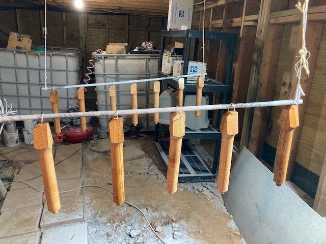

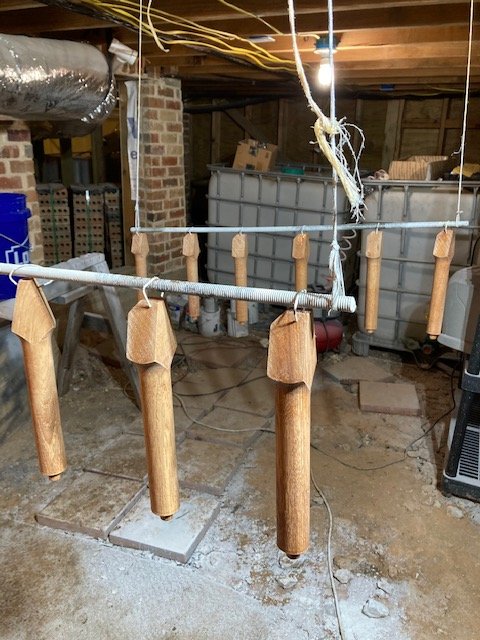

Post by ivaldes1 » Thu Jan 28, 2021 12:38 am

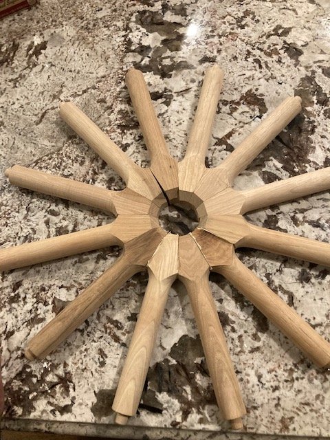

Hello all, Having just finished painting a whole set of wheels viewtopic.php?f=2&t=13134&start=100 I am moving on to doing some more. This time the spokes are not mounted yet individual spokes in a box. I recall possibly Steve Jelf showing a picture of how to hang individual loose spokes for painting but cannot find the picture? I have many unmounted spokes to paint and would like suggestions on how to hang them for maximum painting efficiency. Regards, -- IV

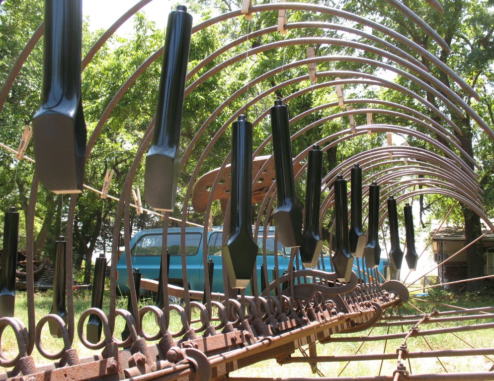

Post by Steve Jelf » Thu Jan 28, 2021 1:10 am

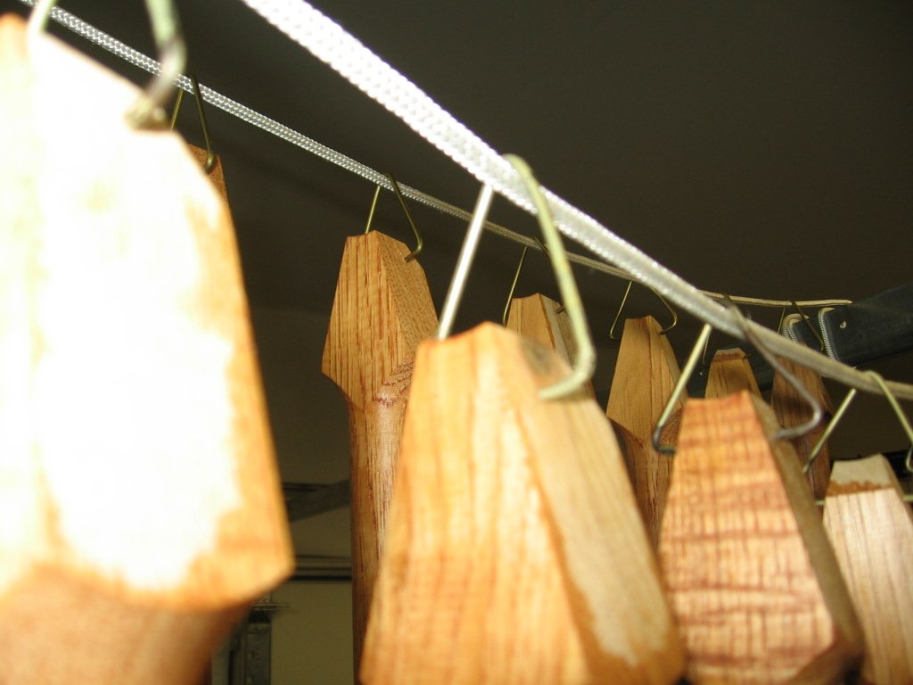

I don't know how efficient it was, but I tied wire around the tenons.

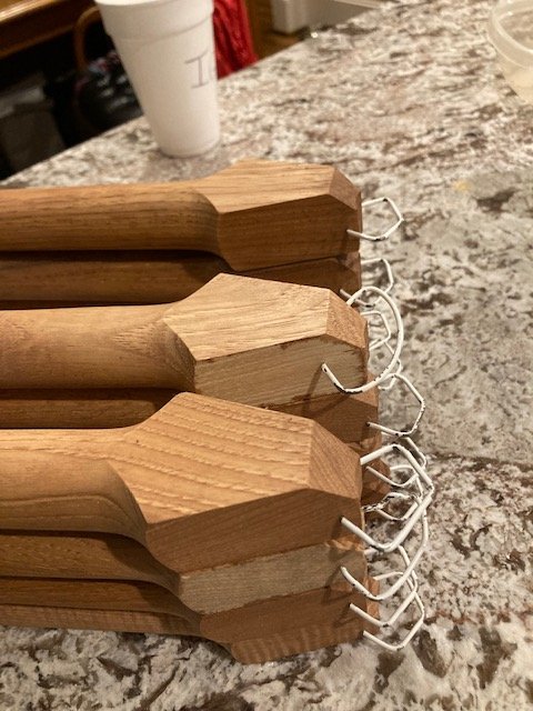

Re: Hanging Individual Wood Spokes for Painting?
Post by CudaMan » Thu Jan 28, 2021 8:50 am

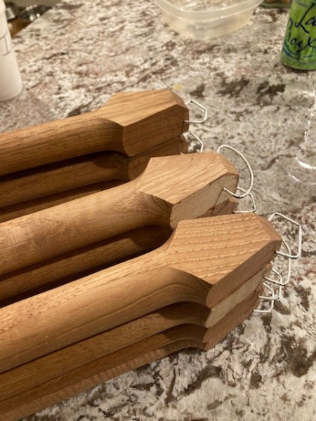

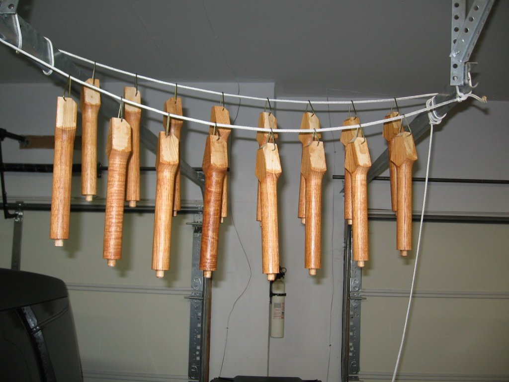

I cut up a couple of coat hangers and bent the pieces into a "V" shape. I sharpened the ends so that they would bite into the spoke a bit.

I have a paint gun and hangers for car body parts but did not use them when painting the spokes. What i did do was lay them out side by side with a minimum gap and spray painted. It is efficient as far as paint usage from a rattle can but not efficient by time to dry, flipping sides. If you are using a paint gun then of course you want to do it all at one time and suspend them.
Post by ivaldes1 » Thu Jan 28, 2021 3:34 pm
Do you put masking tape on the faces that are not supposed to be painted?

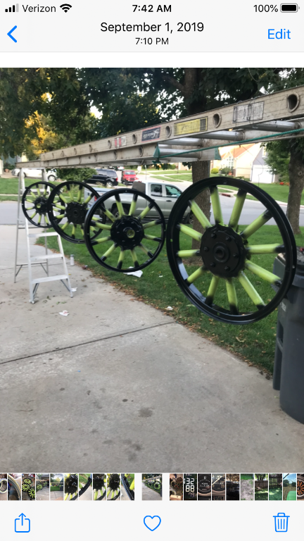

Whatever the method, wheels are difficult to paint. As I recall from previous posts, wheels were dipped then "spin-dried" in the factory. Like most factory methods, not necessarily practical for the home restorer. I have always painted artillery wheels after assembly, both by spray painting and with a brush. I would have to say brush painting an assembled wheel gave the best results. For those who paint parts then assemble, there really is some benefit to be had from "filling" all of the interstices between spokes, hub plates and tenons by painting after assembly.

Rich, I would assemble first then paint but I have a set that are powder coated felloe and hub and am going to do the varnished spokes. So I think that puts me in the category of have to varnish first. I have another assembled set that I am just going to strip and paint the 'normal' way all at once.

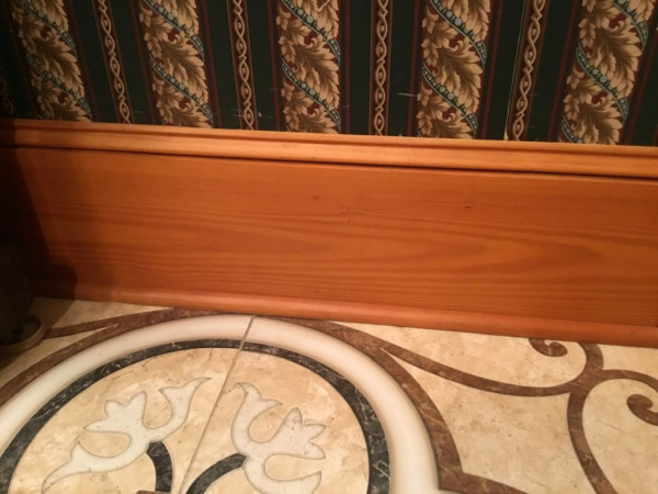

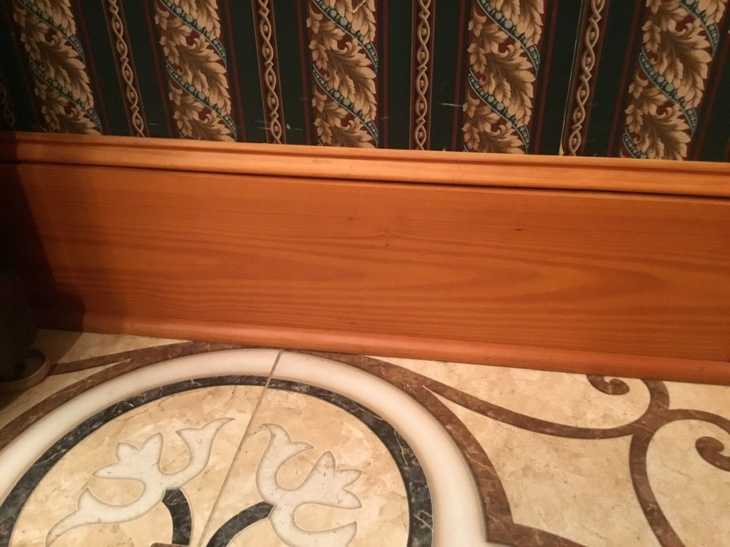

What wood stain/stain color is generally used for wood look spokes? Here are samples: http://tinyurl.com/2gg4xh8n

Check out “Minwax Pecan Polyshades satin” one step stain/polyurethane spray. A very nice color polyurethane. Here are several pictures of the woodwork in the bathroom I stained it with. It will give you a idea of the color. Jim Patrick

I am not seeing that color at local Lowes. I am thinking Sedona Red...

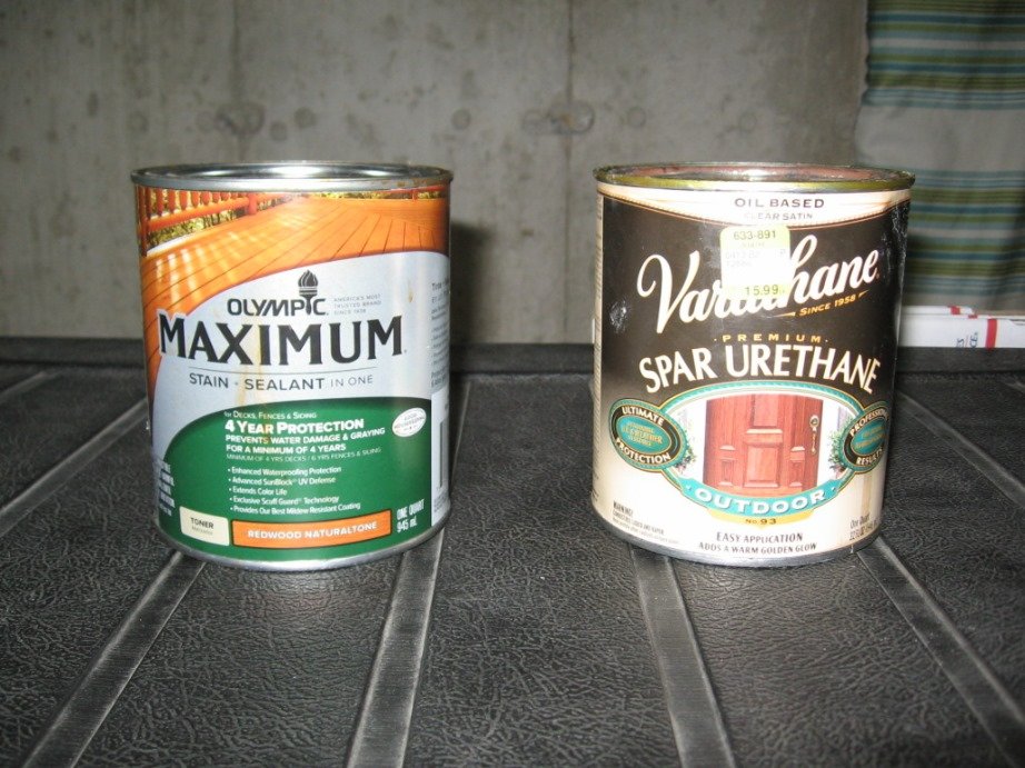

Here is the sealer and top coat that I used.

'Redwood natural tone' so the original factory natural wood stain was somewhat red?

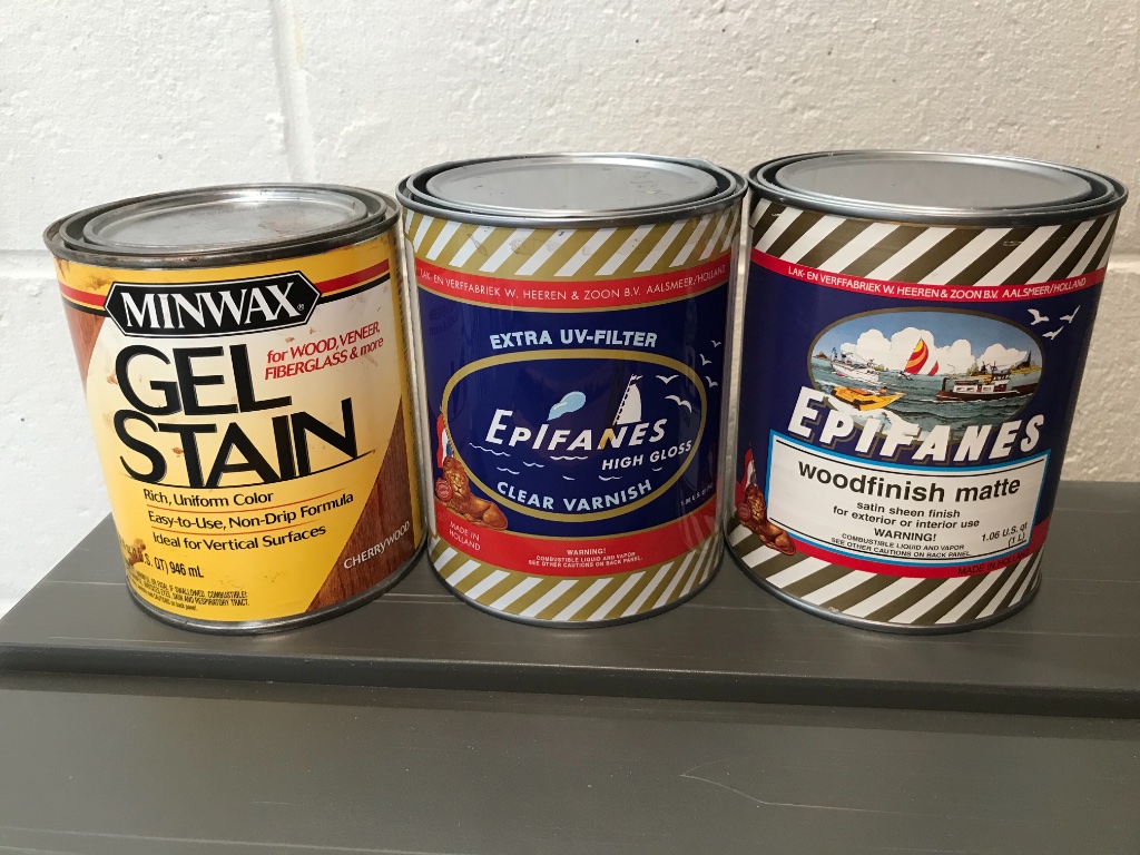

I posted a few days ago on another thread about what I used on the wheels on my Touring so sorry for the repeat.
I first used Minwax Cherry Wood Gel Stain to give the wood some color. I used enough till I liked the shade.
Next, I used several coats of Epifanes Varnish followed by a final coat of the Epifanes Matte since I wanted a matte finish.
I used a foam brush and it leveled out great and you can’t see any brush marks. The wheels on my Touring are non demountable so I did it all with the wheels completely assembled.
I would highly recommend the Epifanes. It is a quality product and I have been very satisfied with the results and the wheels have held up great over the last 10 years.

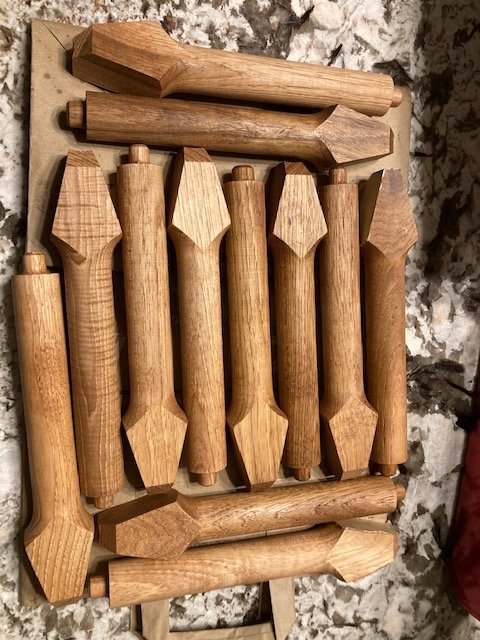

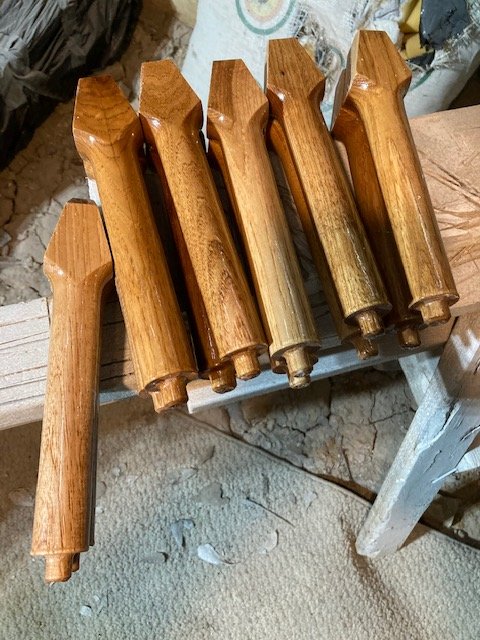

Post by ivaldes1 » Thu Feb 04, 2021 11:32 pm

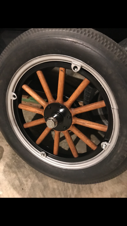

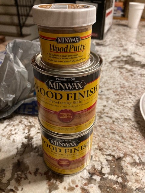

I ended up using Minwax cherry stain and matching putty because I think the originals would look very pale like in the first picture. So here they are stained with a brush then wiped with a paper towel. I am going to be using PPG Shopline (Omni) clear coat automotive 2 coats after this sanding between coats. I am going to masking tape the adjacent tape faces.

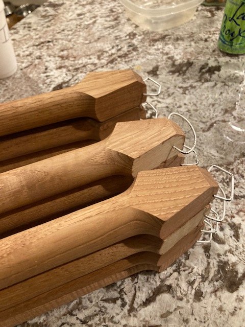

I wish there was a way to easily mask off the adjacent faces that should not be painted. It is an irregular shape to cut out of masking tape 24 times. I wonder if there is a quick way to do it?

I've decided to not mask the adjacent faces and just sand them a bit afterwards on a belt sander. Here goes. The coat hanger clamp method worked well. Just make a little box with a linesman plier and they clamp well. Great idea. This is coat 1.

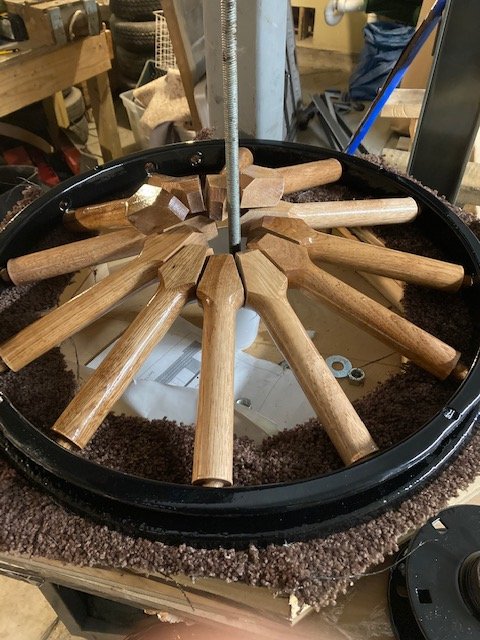

Post by ivaldes1 » Tue Feb 09, 2021 12:21 am
They are now sanded with 400 grit and razor bladed the first coat off of the adjacent faces. The first coat raised what felt like hair stubble in some places. It sanded off easily. I am going to let them sit for a day before I do coat number 2.
Ken Buhler
Posts: 561
First Name: Ken
Last Name: Buhler
Location: Kelowna B.C.
Board Member Since: 2012
Post by Ken Buhler » Tue Feb 09, 2021 1:24 am
I do appreciate that we can experiment with ideas of how to do things, and we often come up with improvements which can change the hobby. In this case, you can pre paint the metal parts and put the wheel together as the factory did, and focus on a correct running wheel. Then touch up the wood fitment with sand paper or an emery strap, then paint or stain. During your life, the wheels will get wet when you wash them or when they get caught in the rain.
Work honestly
Stay true to your word
Get the job done right
Posts: 7309
Post by Allan » Tue Feb 09, 2021 1:38 am
Ignatio, the "hair stubble" may well be the finish you applied getting to know any sealant/natural timber oils. Often they will react and cause minute bubbles in the coat being applied. It is generally not a problem with subsequent coats of finish product.
Hope this works for you.

Post by Modeltmike » Wed Feb 10, 2021 8:52 am
Lots of tape for painting and boiled linseed oil on my spokes. These wheels were already assembled. This is what Leno said he does with is natural spoked wheels. Not a showy finish, but as my grandad would say “good enough for who it is for”.
ivaldes1
Posts: 960
First Name: Ignacio
Last Name: Valdes
Location: Houston, Tx

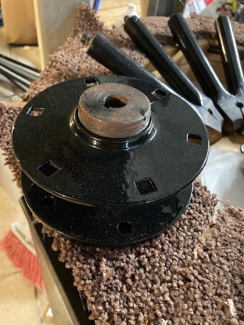

Post by ivaldes1 » Wed Feb 10, 2021 6:56 pm
They are done and so far look gorgeous. The big problem now is my powder coated hub top plate is stuck and won't go down to its proper depth. I was warned about this phenomenon with powder coat. I've tried sanding off some powder coat but so far no go. Other than that I am ready to press the wheel.
