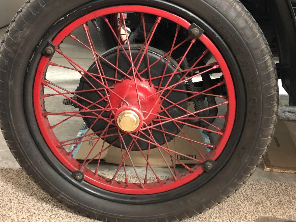

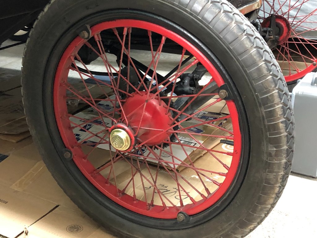

My 1914 Touring came with a set of Hayes wire wheels with demountable rims. Two of the Hubcaps say Hayes on them and I mounted these on the front axle. Two of the caps were plain & I mounted these on the rear axle. Why plain & Hayes logo hubcaps?
I have seen these wheels before on other cars but not with the demountable rims. The rims look to be standard 30 x 3 1/2 types. Any idea when these wheels were made?
I would like to remove the wheels to service the bearings & seals. On standard Ford wheels its pretty easy to get at the split pin & nut or fit the hub puller. All of this looks to be hidden inside the hub of the wheel on these Hayes wheels. Are there any special tools needed? Do you just have to try to winkle the pins out with needle nosed pliers?

Paul, I just had another look at your photos and noticed that your rear wheels are in fact modified front wheels. They seem to be more plentiful, and it has allowed the fitting of the oversized brake drums. It should make no difference to the removal advice I posted.

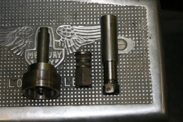

ThreePedalTapDancer
- Posts: 1727
- First Name: Ed
- Last Name: Martin
- Location: Idaho
Re: Hayes Wire Wheels?
Not mine, but this is what the puller looks like.

Thanks for that, I can see how it works now. The base part threads into the wheel hub. Finding one of those might be tough!

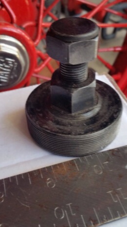

Mike Bender made this one back in 2007 http://www.mtfca.com/discus/messages/29 ... 1176499853
