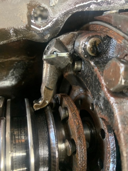

So our attention returned to the transmission where we saw a potential problem. Once the fourth main was removed, the shaft which connects to the UJ was loose. Reluctantly I pushed the problem to one side while I completed the move to my new home.

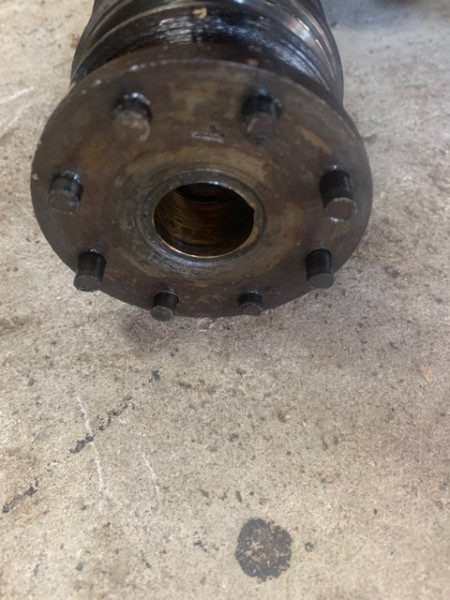

On Sunday I started to remove the motor and completed the work this morning. Sure enough the eight rivets holding the output shaft to the clutch backing plate have all pulled out.
Eight failed rivets
Eight failed rivets
Separated drive shaft
I have never seen this problem previously, anyone else seen anything like it?
I use a Watts clutch and the recommended stronger spring. Could it have caused the failure?

I have found a few with loose rivets, but never one that has failed like that. If there is no damage, it could just be riveted back together. I would suggest that the driven plate be further countersunk so more of the rivet is left to hold the plate in place. It may be that that plate was machined after a previous re-riveting to clean up the face/rivet ends, and a little too much material was removed.

I was going to say the same thing happened to me until I reread that your coupe died. I sheared those 8 rivets but the engine kept running. Just pressing down on the clutch pedal had no effect...major surgery time and commo with Big Flats Rivets was in order. I just considered it a failure due to soft Metal age.

Be sure to check the driven plate where the rivets set. They are bad to crack there. Check between the holes. There are more with cracks then without. Dan
