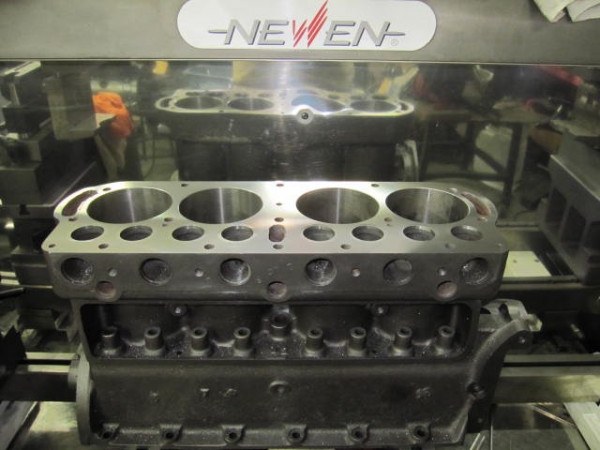

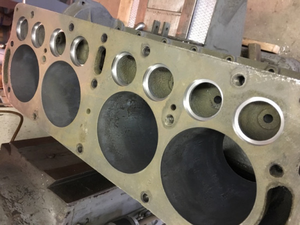

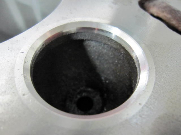

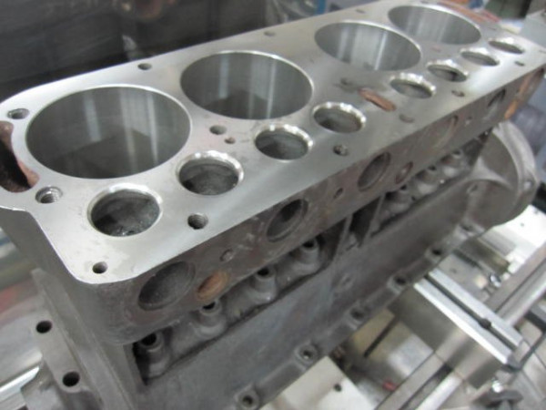

Re: Harden Valve Seats---1927 Engine
Here’s a photo of a typical T block ready for new seats. There is generally no concern for thinning of the block.
