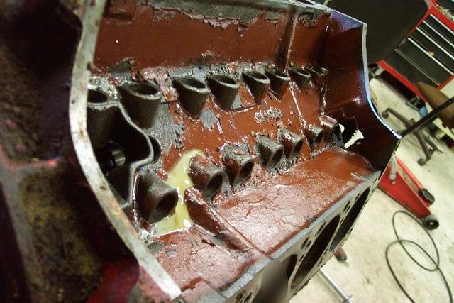

Then again i wouldn't trust it. Just like in your picture, we had an engine that the customer bought because it was cheaper and it was in a boat.
Well half way across the lake he saw the oil pressure going down. a significant amount of paint came off and clogged the pickup screen.
Without having the paint coat the inside of an engine the oil will do the same thing. Once there is an oil film coating the parts it would return as fast as it was painted.. Model T isn't a high performance engine that needs a coating for performance reasons. I don't see any benefit from painting the internals. If Ford felt the need for it he would of painted everything inside and out.

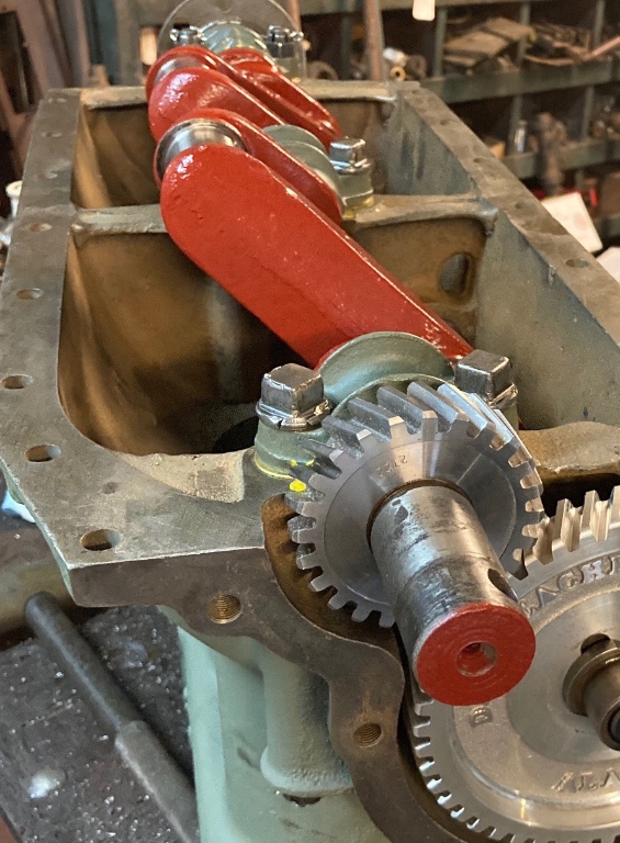

Experience is my teacher, in my use, satisfied with results and no down side in coating with brush Gyptal.
As with any paint, surface prep is mandatory. Have used it since 2003 in my motors and can't find any downside, no flakes, no overheats.
All my crankcases get the coating, many had to be sandblasted from previous rusting of the steel. So after a metal clean surface, flooded with lacquer thinner and let dry. Then brush on single coat, air dry. IMO, the use of Gyptal prevents rusting of the steel as the oil can get moisture from heat / cooling cycles. In addition, the Gyptal seals the sandblasted surfaces, and the slick surface assists oil circulations, and easier drain outs. Plus the inspection pan is easy to wipe out when inspecting rods.
Seems to me, the temperature of the oil that is flying and frothing around inside the painted crankcase isn't increased by any measurable means. The paint is only microns thick, and just can't substantially impact the thermal conductivity of the steel to outside air. Have used it only once on a hogshead, no issues, but normal for me is to do the crankcase as the slick sides help oil that hits against the bare iron cylinder walls to flow easy to the pan dips.

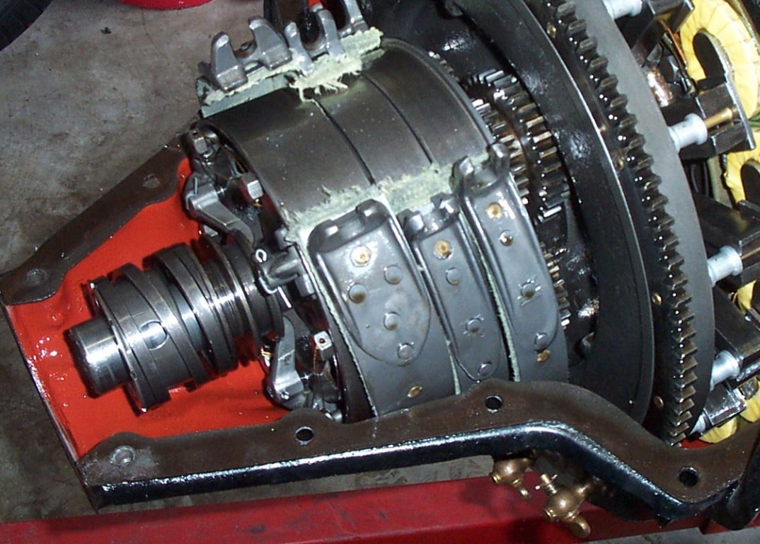

I use Glyptal on my 1926 Franklin. It was originally Glyptaled from the factory, in order to prevent oil seepage out of the crankcase and oil pan, which was also cast aluminum. The other place it was used is in the Franklin transmission, which was ALSO cast aluminum, both the case and the lid.
Coating steel or cast iron with Glyptal does absolutely NOTHING. Neither steel or Cast Iron have voids like cast aluminum does, therefore, what is the point of using it?
Franklin DID NOT do it to have any effect on heat transfer. Their sole and only purpose was to stop oil leakage through porosities and pin holes in the crankcase and transmission castings, which in aluminum are almost impossible to avoid. The crankcase casting is probably 5 feet long, including the front timing gear housing, and the aft flywheel/clutch housing, all of which are a one piece casting. Failure to use Glyptal in cast aluminum crankcases would result in permanent small nuisance leaks that ruined the appearance of the engine. These leaks were never enough to affect engine operation, and did NOT result in large oil losses. Rather they were only tiny seeps that were a problem with fastidious owners.

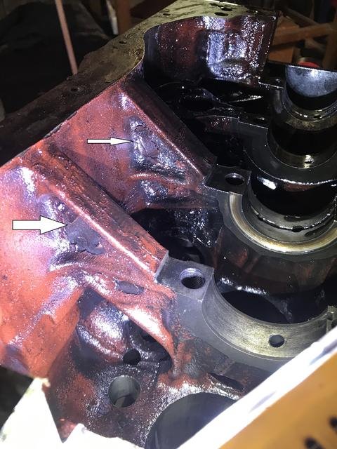

As reluctant as they are to parting with a buck, I seriously doubt that at $38/can of spray paint, or $50/quart, many Model T-ers are coating their blocks with Glyptal in any real quantity (though I do believe Dan, as he is typically very careful with terminology). Now, if you are using generic red varnish readily available from the suppliers, then I'd believe that, and if so, the mention of "Glyptal" is a red herring, and pictures of failed coatings are that of either improperly prepped or cured Glyptal or more likely, simply an inferior product glibly misidentified.
Not an argument for or against, but if one could expect a glyptal coating failure like pictured above, then anyone running a restored mag ring is likely screwed.

I have always babied my T. Many modern high tech engines that rarely leak oil or water, do not need as much maintenance as a very low tech engine that is notorious for leaking oil and water and thus need these topped off, often. Many Model T’rs, believing that a Model T engine is tough and can go for long periods without maintenance, do not do the necessary maintenance as often as needed, sometimes delaying necessary maintenance.
A lot of talk regarding retention of heat that can possibly be caused by coating the interior surfaces with Glyptal has been put forth here and I’m sure we are all in agreement that one of the quickest ways to overheat an engine is to let it run low on oil. If the engine oil is low, which, with all the leaking, is common in the Model T, the oil klinging to the interior surfaces of the oil pan, block, transmission drums and hogshead, could actually be a factor in maintaining a serviceable oil level and a low, but serviceable oil level before starting the engine could quickly become dangerously low and unserviceable once the engine has started and the splashing oil klings to the vast amount of interior surfaces. Glyptal, coating and sealing these rough porous interior surfaces, makes them smooth and slick so that the oil quickly sheds instead of remaining on these surfaces, possibly avoiding the oil level going below a safe level.
If a $50.00 expenditure for a quart of Glyptal and a little extra application work while the engine is open and dismantled is needed to help my T run more efficiently and last longer, then I think it is a good investment in time and money. Finally, if you believe that an interior coat of Glyptal retains heat inside the engine, the same argument can be made that coating the exterior of the engine can also retain heat, but since the internal combustion engine was invented, the exterior of engines have been painted to protect the steel from deterioration and for appearance and I have never heard an argument claiming that painting an engine will cause overheating, because it won’t. Many high end auto manufacturers such as MG and Rolls Royce, as well as professional racers and ship builders recognize the merits in coating the interior of engines with Glyptal or an equivalent coating and if it is good enough for a high tech engine, the same advantages that it provides them are even more advantageous for increasing the efficiency of the low tech T engine.
I will continue to coat the interior of my T engine with Glyptal, as I was convinced long ago by a majority of highly respected MTFCA member/Model T experts, who were so dedicated to the T and so influential in advising those of us back then with less experience, that coating the interior of an engine with Glyptal does much more than making the interior look brighter. It actually increases the efficiency of the oil by helping to maintain a safe oil level and prevents contamination of the oil from impurities from the bare metal and cast iron. I say this because before coating my engine with Glyptal, my oil would turn black a lot faster than it does now. Now, it retains its’ clean, amber color, much longer. Jim Patrick

"A buddy of mine restores antique aircraft. Many of those aircraft engines used the glyptal in the crankcases but later found that it was contaminating the oil."
"I don't think it makes much difference personally, unless you don't prep the block for it correctly and it peels off and stops up the oil passages."
"I've never used it in any of my engines and never had any problem with the oil making it back to the pan."
"If getting a few spoonful's of oil back in the crankcase faster will make any difference, you have problems paint won't solve."
"on a street engine there is more risk of Glyptol eventually ending up where it can cause problems than there is benefit(real or imagined) from doing it."
"Doing it on an old casting, even if the part is is thoroughly cleaned, increases the risk of adhesion problems over what would be the case with a new casting."
"Glyptal has to be applied correctly and the surface has to be clean (really clean) and after you apply it you have to bake it. A master engine builder told me that painting the inside of an engine block adds to the risk of things that can plug lines (paint flakes). A lot of work for no advantage."
"I was told long ago by my machinist not to do it. He had seen cases where it flaked off, blocking the oil pick-up screen."
"Ask yourself this ... How much work am I in for (in order to rectify the problem) if I start seeing paint flakes in the oil?"
" ... just not worth the risk for what could very well be minimal benefit, if any benefit at all."
