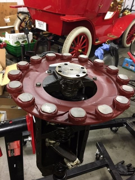

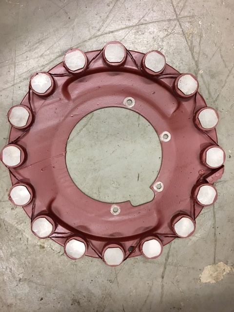

So I’m building a 13 engine and I have several mag coils.
A “tin” disc
A double stack
A single stack
Which is correct?
They are all freshly rebuilt
A “tin” disc
A double stack
A single stack
Which is correct?

The 13 has a field coil all by it self, it takes the small round double stack,the magnet plates are the long ones, Years ago Wally told me these where the ones that gave every one the broken wrist. I would run the double stack oval that is 14 year and have no problems, noe one but you would know what is in there.

All ‘13’s had double stack field coils. Most I’ve seen are what Joe mentioned.
What’s in there now might not be original.
How thick are your magnets? I think the change from 5/8” to 3/4” magnets was late ‘12 or early ‘13..
If you have 3/4” magnets, then the earlier tin field coil wont work. If you have 5/8” magnets, the single stack won't work (won't function very good and would need 1/8” more shims).

The engine is being built from parts so I will see what fits.

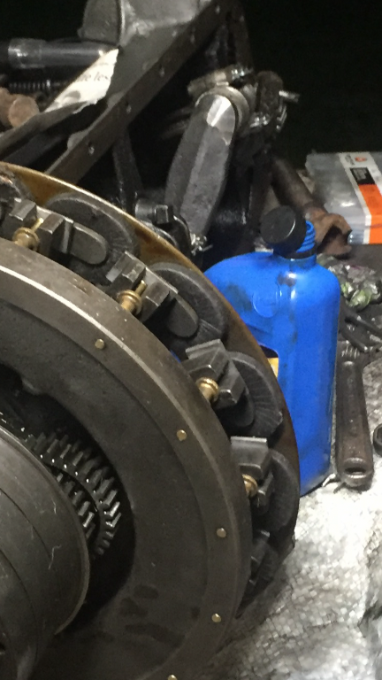

Hi There, here the Magneto restoration R.V. Anderson did for me. My 1914 speedster is really please with it. Well done

That coil certainly looks similar to the one I have.
