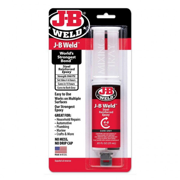

jiminbartow wrote: ↑Fri Feb 05, 2021 4:45 pmAdam, the exhaust large brass nut that secures the exhaust pipe to the exhaust manifold fits the bill, but I seriously doubt that hot glue will hold. It is a good idea though, only use the strongest two part epoxy you can find.
Hot glue is easy to remove. The Worlds Strongest Epoxy doesn’t sound like much fun to deal with unless you are just going to throw the cap away.
I do agree that a zinc die cast cap that is stuck because it is swollen will probably never come out with a nut hot-glued to it, In this case, the cap is probably junk anyway but many times the cap is stuck tightly because it was put on without a gasket. In this case, it should only take the shock of the first one or two rattles with a small impact to loosen it.
I would imagine he doesn’t want to harm his cap. Generally I just carefully tap the fins with a hardwood block, or sometimes use two vise-grips, but both those methods have to be done with a great deal of finesse and care. If that isn’t within ones skill level, you quickly have a cap with broken ears.

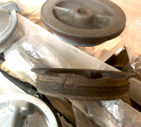

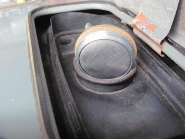

https://mtfca.com/phpBB3/viewtopic.php? ... ap#p124724BLB27 wrote: ↑Sat Feb 06, 2021 4:57 pmThe cap has been on for 60 years so I am not concerned about fumes. Having said that, I think I will take it off in pieces. Any more suggestions on how to do this would be appreciated. I am a little concerned about pieces getting into the tank, especially very small particles.
You have never indicted what style gas cap you have either in this discussion or the previous one. If we are to assume it is a "complete" pot metal style cap with the bottom plate as shown in the picture - that would help prevent pieces from falling in if you gently attack the top. BUT as Adam said in the previous discussion "There is a paper “gas cap gasket” that goes on the cap. 90% of its job is preventing the cap from “taking a set” and getting stuck. " So have you tried running a knife edge around the cap to separate it from the gasket or tank?
Jim's suggestion to epoxy a nut to the top of the cap is also a good idea to prevent pieces from falling in.
I would have a vacuum handy to remove any pieces that break off as you go.
If you remove the tank work on it (drilling or shipping) upside down so nothing falls in

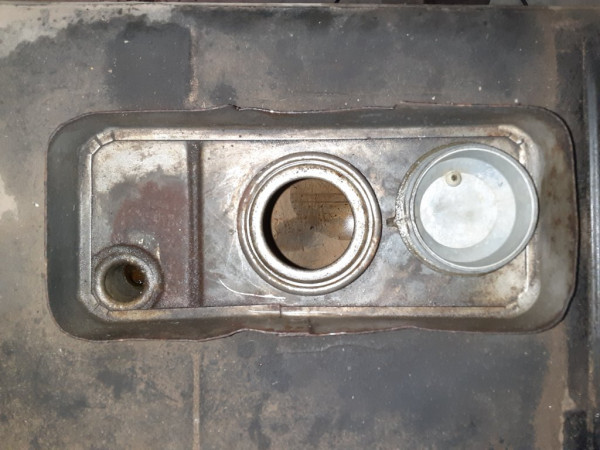

Anyone who knows Model T's knows what a 1927 gas cap looks like! That style cap was introduced in 1925. I have an original on my car, and it works fine. Some of them survived, but most haven't. As I noted in an article I wrote years ago for the Vintage Ford, you will often fine the anti splash insert at the bottom of the tank. Mine fell out a few years back, and I dabbed Krazy Glue around the edge, and it has held for years.
- Posts: 6609
Re: Gas Cap-Still Can't Get It Off
Bruce has never never indicated what cap style cap he has (in words or pictures), only that he has a 1927 coupe tank! As you well know not all Model T's have been maintained with the correct part/year. I inserted the picture of the pot metal cap, not Bruce. So we still don't knowOriginal Smith wrote: ↑Sun Feb 07, 2021 11:18 amAnyone who knows Model T's knows what a 1927 gas cap looks like! That style cap was introduced in 1925. I have an original on my car, and it works fine. Some of them survived, but most haven't. As I noted in an article I wrote years ago for the Vintage Ford, you will often fine the anti splash insert at the bottom of the tank. Mine fell out a few years back, and I dabbed Krazy Glue around the edge, and it has held for years.

I like the idea of epoxying a nut on the top of the cap. If the top breaks then chip away the rest and try and salvage the splash insert on the bottom of the cap as shown in the photo. As Larry noted it is often missing and a desirable piece to restore an original. You might use some sticky tape on the cap as you go to capture the broken pieces and the splash insert.

The epoxy can easily be removed by immersing the cap and nut in a covered bowl of lacquer thinner (covered so it will not evaporate). It may take several days or a week, but the lacquer thinner will eventually soften and loosen the epoxy and the nut will drop off. Jim Patrick

Seeing i know nothing of model T's Dan's picture was the first i have seen of this cap. The center looks heavy enough to try a Easy Out??? Bud.

If its an original style pot metal cap with the baffle plate under it - its a keeper. Someone might buy it just for the plate to refurbish an original scripted one. May just needs a clean up. as isTmooreheadf wrote: ↑Mon Feb 08, 2021 7:33 pmI got mine out using Gibbs penetrating fluid. I used plumbers putty and built a dam around the neck of the tank so as to make a pool of Gibbs soaking the threads continuously. I smacked with a hammer daily and filled the pool daily. Did this for a week. Took the cap off with a barrel bung wrench. The cap came off in once piece but I did not use it again. Replaced it with a brass one.

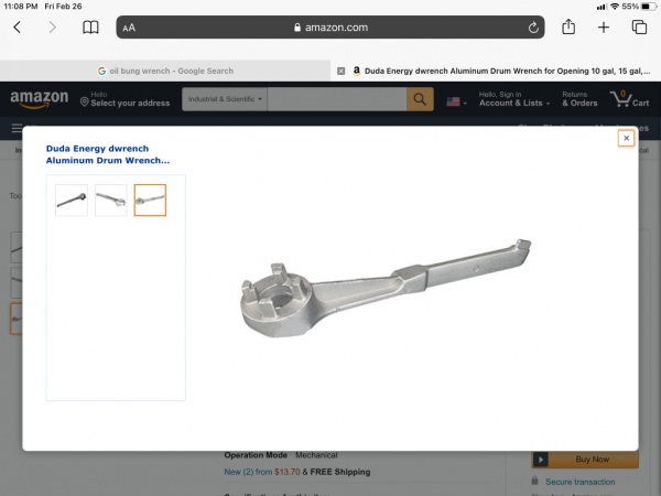

What does a wrench used to remove caps from an oil barrel look like?

After three weeks, forum members are still trying to help Bruce, the originator of this thread, get his cap off. We have not heard back from Bruce since the beginning of this thread. Bruce, did you ever get the cap off? If so, how? Jim Patrick
- Posts: 5574
He posted today, it is like 4th one up. Guessing not as he is asking what a bung wrench looks like. Sorry but that cap would have been off 3 weeks ago if were mine. Maybe it has been in the car for over 60 years but at a point somethings need to be replaced like paint. If it does not screw out now, it isn't going to screw back in later.
https://www.google.com/search?client=fi ... ung+wrench

Oil drum bung wrench.

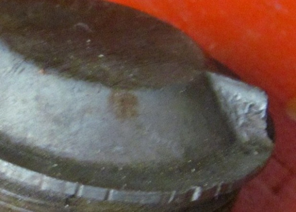

I got it off!!
I applied "Yield" to it. My grandson and I each used a punch and hammer on the wings and hit at the same time.

Well placed small hammer blows will usually work every time. Glad you finally got it off!
