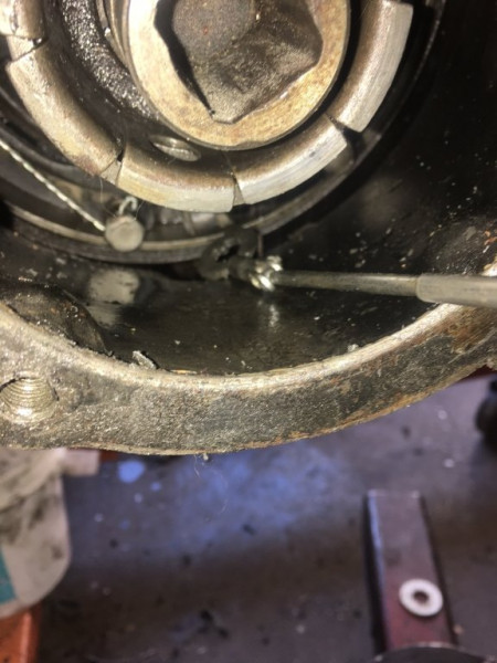

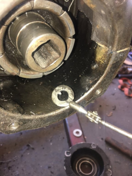

I went fishing today. Since it is out of season (and I haven't a fishing license) please do not alert the warden!
BTW, this can (and did) happen even when most precautions are taken. That driven shaft and the fourth main have a long story attached, be relieved to have missed the saga involved!

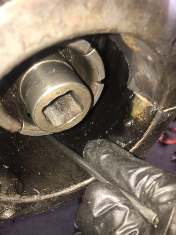

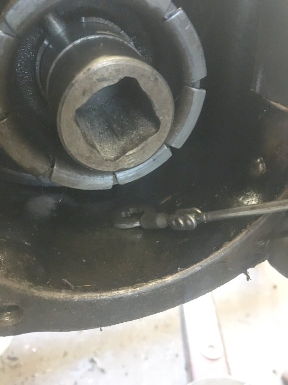

I spent 4 hours over at the transmission fishing hole a while back trying to land a band nut species. Nearly landed it but fell off reeling in; no hits after that. Luckily Bob Jablonski gave me a tip on another great spot to try; the starter hole. That's where I landed this baby!

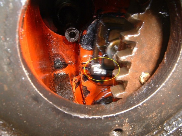

Four years ago, I dropped the washer when just buttoning up things after the engine rebuild, right before installing engine into the car.
I tipped the engine, nose up. Luckily the washer dropped out of the back end. The fourth main was not installed yet.

Art, you pegged the stage of assembly exactly. On engine stand with freshly mounted hogshead. I tried through the transmission cover access without luck and then found that little drain slot on the bottom (where else would a drain be?) where my magnet JUST FIT between band (wood lining of course) and pan. A bite on the first cast! My plan was to turn the engine tranny down as my next try... anything to avoid pulling the hogshead again!
Dan we most all think we are immortal at times. I fell prey to stupidity and went with a firm and complete rag packing but no dental floss. I use zip ties to hold the band ears. I did reverse and low just fine. What happened is that as I was fumbling around with the brake nut (hmm breakfast, brake nut flakes?) the zip tie slipped off and the spring powered the washer into the very top of the rag... just missing the open transmission access door. I saw it disappear behind the rag and could never make a shot like that again if I tried.
I usually don’t use pedal springs as the wooden bands don’t need them. In fact I have only started using the springs again so as to give the washers and nuts a sporting chance... sort of like squeezing a hook barb closed. I am sure that washer suffered no barb injury!
I see no one chimed in with doom and gloom prophecy about that 4th main... very wise Grasshopper!
