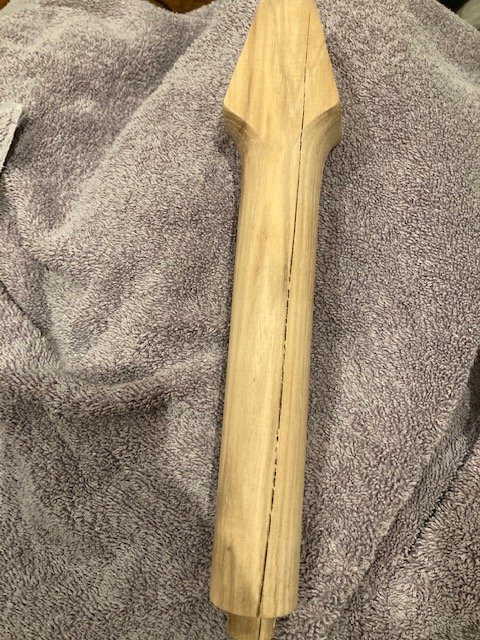

One of my new spokes has a crack in it pictured. When is a spoke too crack too cracked to use? I've ordered a new one. $12 per spoke x 12 = $144 per wheel, wow.

Since nobody has actually said it directly, I will, do not use that cracked spoke. That being said, I agree with the previous responses.

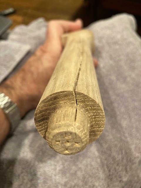

The split alone is grounds for the bin.
From the end grain, it does look like oak.
Oak is not a good material for spokes.
As an Englishman, I have to say that the properties of American shagbark hickory make it way better for spokes than anything that grows over here.

I don’t want to be a boo bird, but I would be real skeptical of ALL the spokes purchased at the same time! I’d ask the supplier to replace them all and also give you a moisture reading using a pin type moisture meter (I.e.— turned at 7-9% moisture)
The quick answer is the spoke you show was probably machined either ‘green’ or wet. Now that it has dried to your area moisture it shrinks, forms a stress line off center and cracks. The as made environment on the one is the same as the others made at the same time.

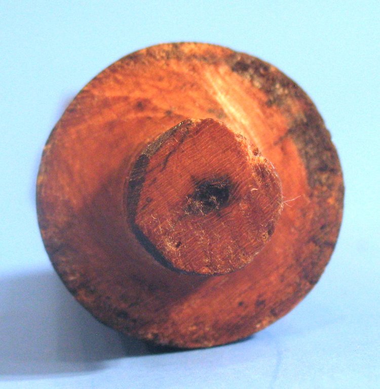

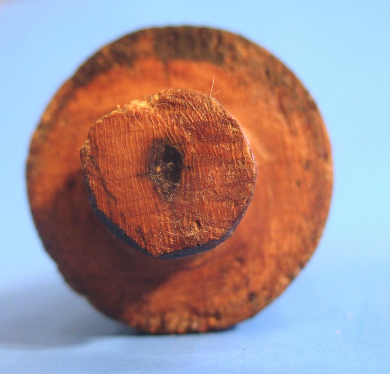

Comparing the split spoke with this known hickory tenon, I suspect you may have oak or something else other than hickory, but for me it's not a slam dunk. I would ask the supplier what wood your spokes are. If they are not hickory I would return them all for a refund. If they are hickory I would get a replacement for the split spoke and move on. If you do need to return them, the upside is that hickory spokes from Lang's cost 50¢ less.

That spoke would most likely never give you any trouble. That being said, it looks terrible and I wouldn't want it in my car. Yes, get it replaced. While you should ask about what species of wood is being supplied to you, I can't see anything in your photos that tells me your spoke isn't hickory. It's just not a good enough photo to determine that, (which I understand, you weren't asking about anyway).
If you want to be super fussy, for the strongest spoke, I would prefer that the grain pattern be rotated 90 degrees from its current condition. I believe that Stutzman does them that way as well.

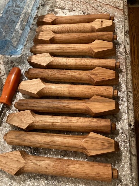

Here is 11, sanded and stained, ready to clear coat. The twelfth is in the mail.

I don't know about the tree that was used to make the spoke in my photos, but the spoke is one that was broken in a wreck and is about ten years old.

It actually is not “cracked”, it is “checked” (from drying as pointed out). This will not measurably affect the strength, but I completely agree, it should not have been sent out.

$11.50/spoke x 12 per wheel = $138/wheel x 4 = $552 per car. They look great and will last a long time but that's a spicy meatball on spokes. I tell my non-model T diseased friends and acquaintances on how it is very easy to spend $400+ on a model T wheel.

If any one has cut as much wood as I have you can see in the picture that some of them are hickory from the color and grain, The crack can come from any piece of wood that is not sealed at an end. Years ago I took a hickory down just for the making of spokes, I did not paint the end while it was drying out and all the wood cracked so they all went into my outside wood burner!
