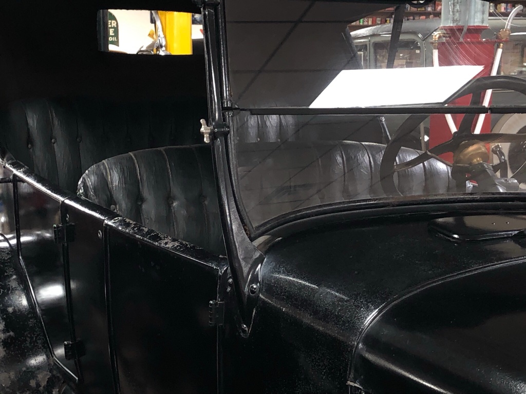

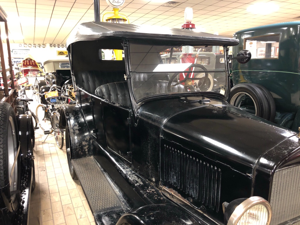

Careful inspection is needed, the original paint of a very well preserved T will have a lot of sheen left from the extremely glossy factory finish. But there have to be areas that will show flaking and bare metal under. Any paint over the upholstery or any touch up of worn spots and welting trim would mean a re-paint. And chassis areas will show little wear , like spring shackles.
Very original , real low mileage 1926 touring showing off its original finish in drag racer Don Garlits collection in Ocala FL.

Perfect example Dan, Thanks for posting.
Hank

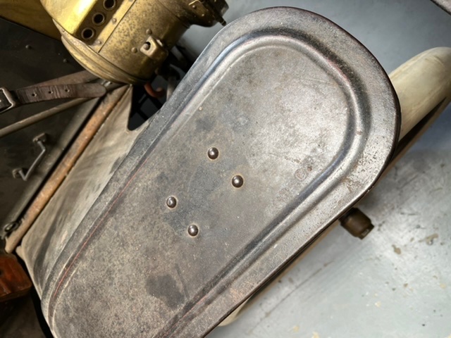

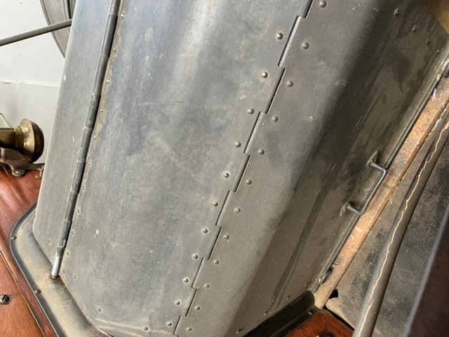

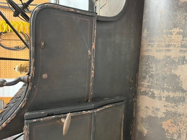

Re: How can I tell if the paint on my T is original factory.
Original paint on 1910 touring.
