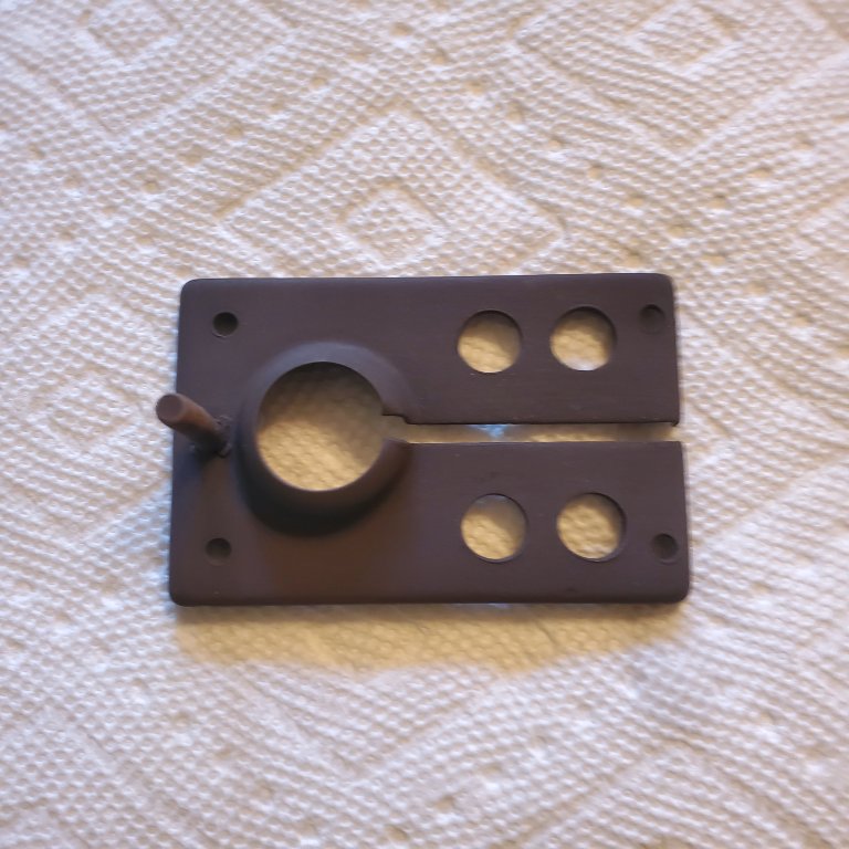

I've had good luck with Caswell black oxide solution. Photo below is a brass top from a coil.
