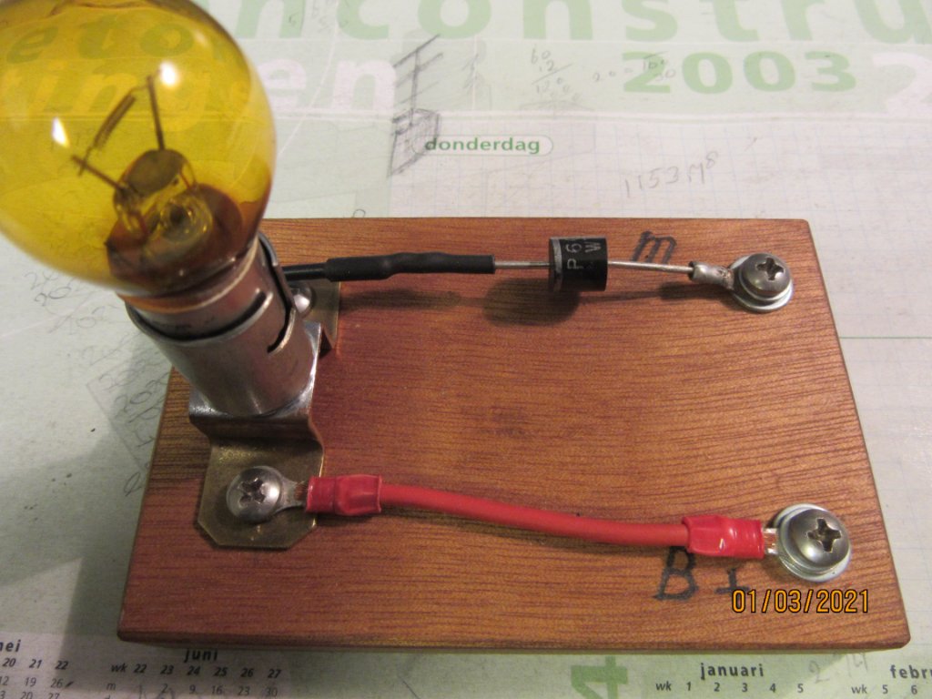

I just installed a Hot Shot Charger Kit ( Langs hot-shot-c) in a 1913 runabout.
The Charger Kit work well but as I shut down the engine there is a red glow in the light bulb.
The mounting is done as on the paper that came with the kit.
What did I did wrong? the car is running great on magneto and battery. Get about 33Vac out of the magneto.

Maybe you have the diode installed the wrong way or it's defective and allowing a small amount of current from the battery back thru it, but then you would not be charging the battery. Might want to also make sure nothing is grounded between the bulb diode.

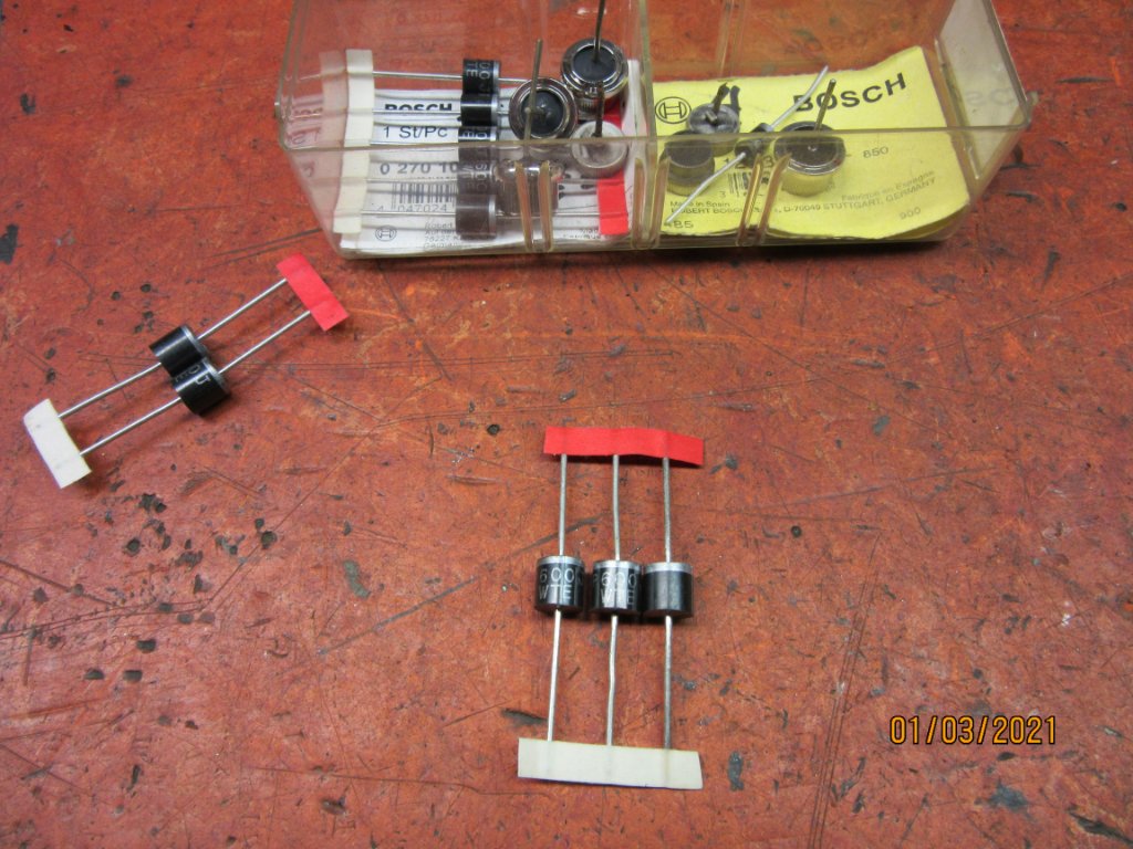

The diode is shot 34.6 Ohm one way and 34.6 Ohm the other way should be open.
As I have no replacement, I was wondering if I can use a diode for a cutout as replacement?

Andre' , To morrow morning three Diode's are on your way .
Toon
