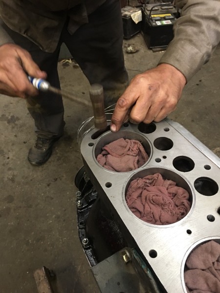

Re: maximum cylinder bore
We run a 3.880" bore on the Wild Cherry II race car. That's.130" oversize. The only problem we have had is it leaves the space between the front and rear pairs of cylinders very narrow. At 10:1 compression it is difficult to keep head gaskets intact. We have had to put stainless O-rings on the block deck and use a solid copper head gasket made for us by Kevin. None of this should be necessary with a flathead but you may want to see if some of the gasket fire ring protrudes out into the cylinder.
