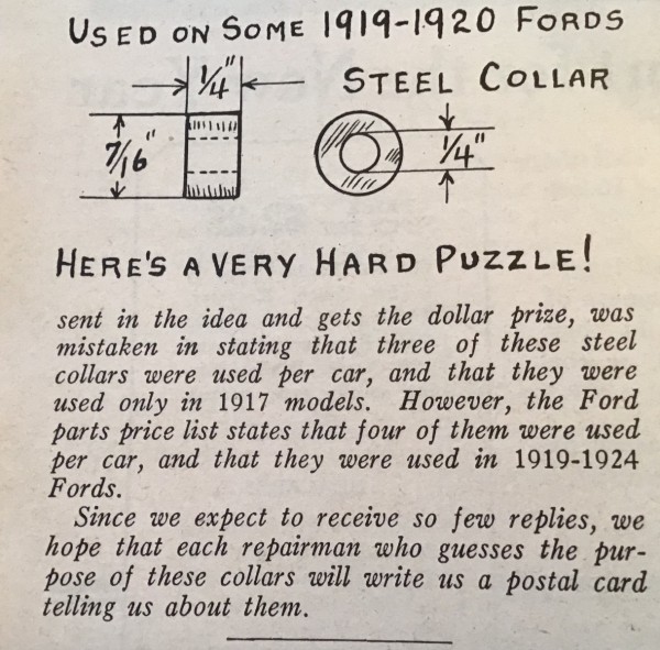

For some Ford stock part fun, here’s one.
“Re: Was it ever a stock part?
Report Quote
Post by Rich Bingham » Fri Mar 08, 2019 8:08 am
Dan, what publication did that puzzle appear in, and when ? It would be a treat to see more ! (Maybe some of us could earn that $1.00 prize ! :D
These Puzzels appeared in Ford Owner and Dealer in mid- 1920’s.
IF you can guess this puzzle you are indeed a Model T expert!

The only place I can think that would use that small of bolt/screw would be something to do with the coil box switch. Maybe as a standoff where it mount to the box.
Posts: 5263
Re: Stock Ford Part Puzzle

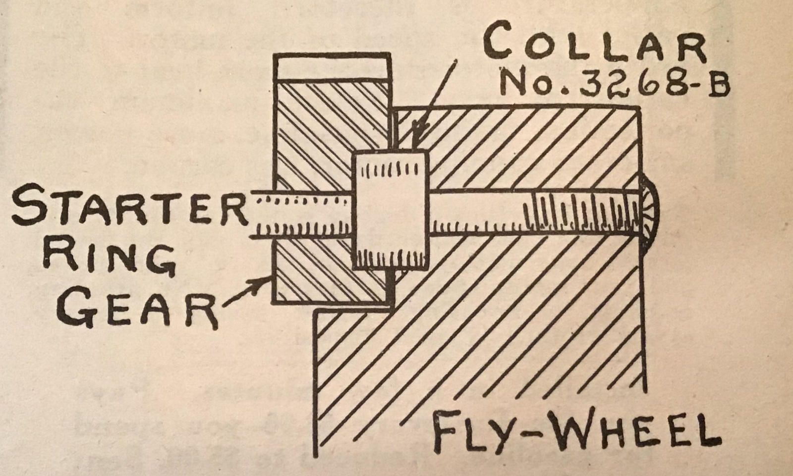

Post by RajoRacer » Fri Mar 08, 2019 10:28 am
Starter ring gear indexer to flywheel.

Post by Mark Gregush » Fri Mar 08, 2019 10:39 am
Steve, I think that is correct. ;) Tend to forget about those, they are so few and far in between.

Steve can be known as one of the “experts”!
His reply is correct on those little collars.

Two cents each...Add the additional machining cost of the flywheel and ring gear to that.
