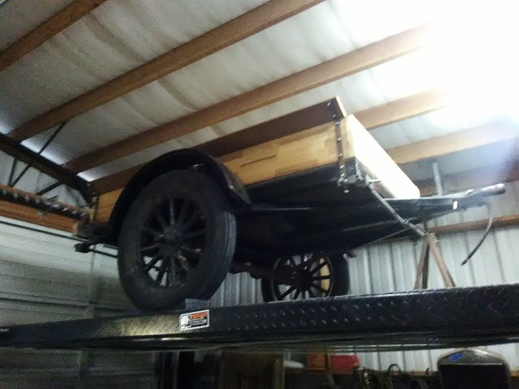

On similar threads, I have enthusiastically touted my 4-poster. I love it. Everyone thinks the rails are in the way, they are not.Norman Kling wrote: ↑Sun Mar 07, 2021 6:57 pmI have seen them but not had experience with them. However, if you plan to park another car underneath, it could be a problem, because I have yet to see either a T or an A that didn't drip at a little oil.
And, I do keep my '94 T-bird under it with the Fordor currently up above it, I just keep the drip trays, plus as extra layer of safety,
a hunk of cardboard over the top of the "bird" also, just in case. Never any problems. And like someone said, it's also portable, in case I need to move it to another location.

I have a 4 post hoist and I like it a lot, it is handy for unloading stuff out of the back of a truck and lowering it to the ground, I can use it as a adjustable height work bench, I have even used it as a table for a large gathering (shop tour/breakfast). As already mentioned I also use it to be able to get 1 more car in the shop than would otherwise fit, I think a 4 post is more versatile.

I have a BendPac 4 post and keep a car under a T with drip pans. I made my own as the ones made for the lift were pretty pricey. If you decide to get one make sure it is tall enough. I ordered the tallest one available but it still is not tall enough to get most of my early T's underneath with the tops up and my Hack and Centerdoor are relegated to the upper berth!
