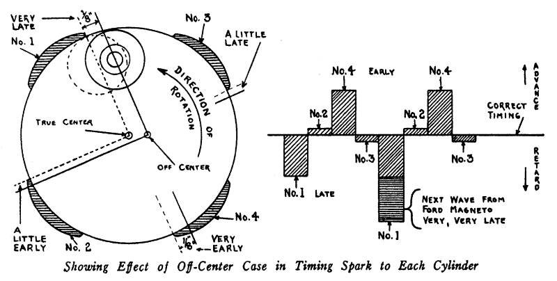

Here is an illustration from the past that is helpful in visualizing the impact of the Timing cover centering about the CAM.
The ID of the roller timer contacts is 2.125" which equates to a circumference of 6.675" and 720 degrees of crank shaft rotation given the 2:1 gear ratio. That means the +/- 1/8" variation indicated in the diagram corresponds to +/- 13.5 degrees of ignition timing variation assuming all 4 coils are adjusted for precisely the same dwell time to fire spark. Note that improperly adjusted coils with varying dwell time to fire spark COULD actually function to compensate for timing error due to timing cover misalignment OR could function to be additive to that error making it even worse. This can explain why differing methods of coil adjustment yield differing results in engine performance. Engine performance should not change depending upon the location coils are installed in the coil box with properly adjusted coils (equal and consistent firing time). If coil position in the coil box Does matter, it may indicate timing cover misalignment And coils with differing dwell times to fire spark.
Note that this analysis does NOT apply to Electronic Timers. They are immune to timing cover misalignment because they use a single CAM position sensor used to determine ignition timing. Spark lever adjustment for optimal engine performance is common for all 4 cylinders.

SurfCityGene
- Posts: 681
- First Name: Gene
- Last Name: Carrothers
Re: Fit of timer in timing cover
John, Just another good reason to check out the new I and E timers!
There is a real reason that the guys making the new Anderson will resize your timer to fit your cover and why the Montana guys will work all night to make sure the timing adj is spot on.
Thanks Mike for posting a great explanation!

What Mike speaks of coil timing to fire is all true.
Yet, what is a deceiving in using an example of 1/8" off center and showing 13+ degrees off on firing is that it is for illustrative purpose only. I won't do the calculations and will assume that the author of that old article is correct in their calculations. It does make for an alarming misfire value and I think that's pretty much the point. However, when folks are questioning the size of the timer housing or the fit to the front of the engine, the misalignment is very very small relative to .125" offset of the timer housing to the roller in the drawing. That small misalignment will be a fraction of .125" and thus a fraction of 13 degree mis-timing. It most certainly will not be optimal, though. Very little on a T is optimal anyway and I am not arguing for sloppy work or to disregard it...just to understand the nature of the issue.
Running on battery will take all run-out of the roller to timer body, use it to the worst possible outcome, and cause lower performance but the car was not designed to run on a battery, it was designed to run on its internal magneto. If you are trying to optimize a defective car without attacking the Root Cause, that may be another story entirely.
And again, what absolutely is true, is that on Magneto, the coils are going to fire when they are going to fire and that is NOT at every single leading edge of a misaligned timer, it is when the current to the coil reaches the point to which it was set (or TTF for Mike's method). It would be an extremely unlucky or likely, unconscious individual that would select the very specific point on the Mag node leading edge to leave their timer precisely where the car runs it's worst since that point on the spark quadrant is razor thin within the totality of the range of quadrant that the car wants to run at for that particular RPM.
