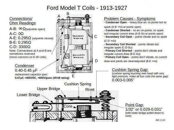

I prefer this chart that John Carter developed for simple multi-meter tests:

Yes, indeed; there is a lot too it but well worth the time and effort to learn and understand.Moral of the story - A coil that can make a spark plug buzz and look good to the eye doesn't mean it will run smooth in the car.
That test merely indicates each coil if firing. There is a Huge difference between a Model T engine that "runs" and one that runs well. The difference is largely dependent upon on ignition Timing to which the coils play an integral role. Unfortunately, you can't adjust coils to all fire spark after the same dwell Time and do so consistently using a multi meter. You can email me (mictel at comcast dot net) if you would like to know more; I can't discuss more here because I developed and market tools used to make the job easy.Ran nice and when tested I lost a cylinder when each plug was shorted out.
