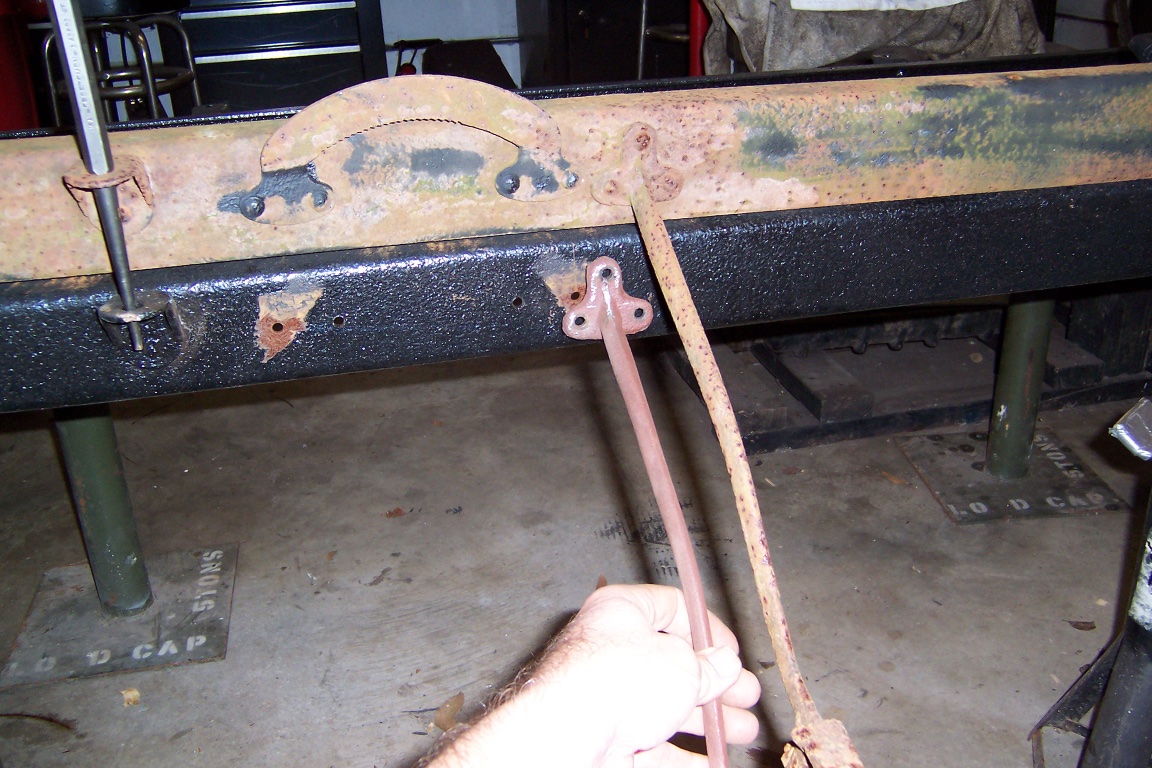

The '15 frame has the running board brackets riveted. In this photo, a partial and poor '15 frame is used as template to drill holes in a later frame to mount the forged running board brackets. Hot rivets used in this one.

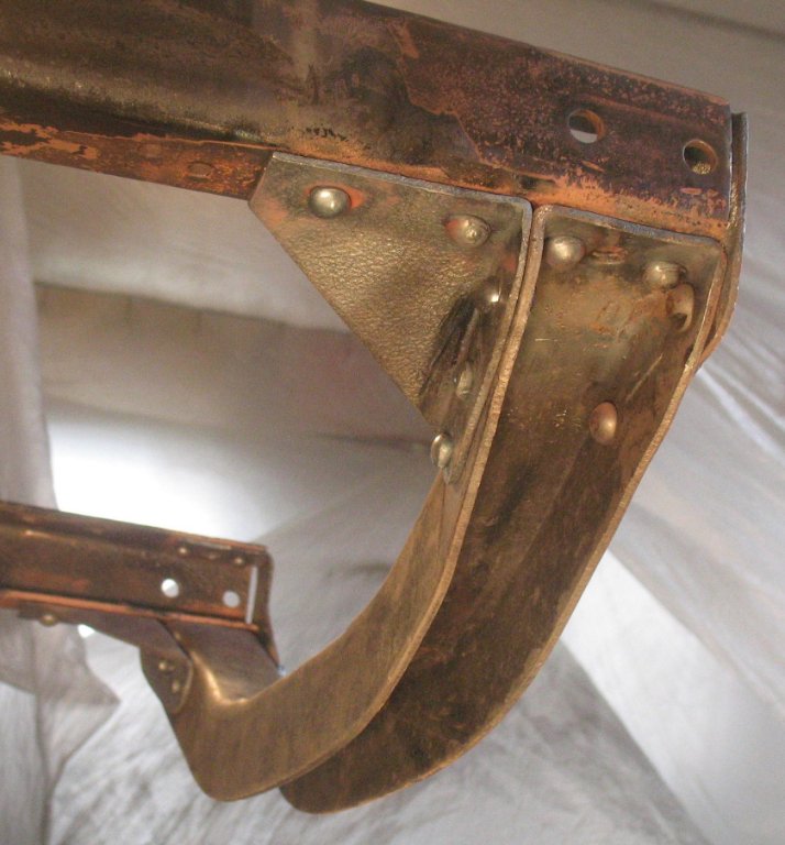

I had to replace the front cross member in my 1915. Here are some photos.

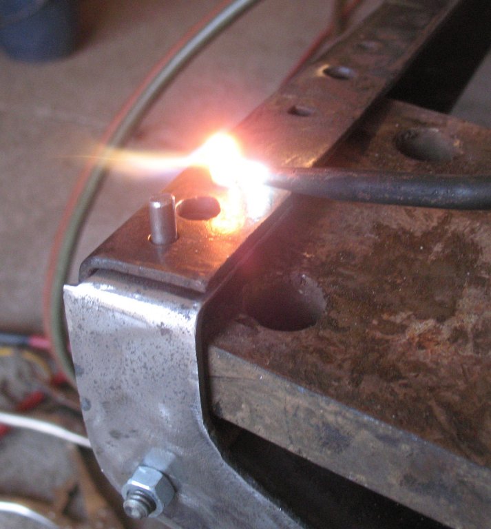

I bolted in the new piece to keep the holes lined up and replaced the bolts with rivets one or two at a time. I found it most convenient to install a rivet, back it up, and heat it in place.
My neighbor kept the rivets hot and I mashed them.
The awkward part was getting the backup weight in place and clamping it to stay.
I found it most convenient to rivet the brackets on the cross member out of the car and install them together.
I think we did a pretty good job for a couple of novices.
