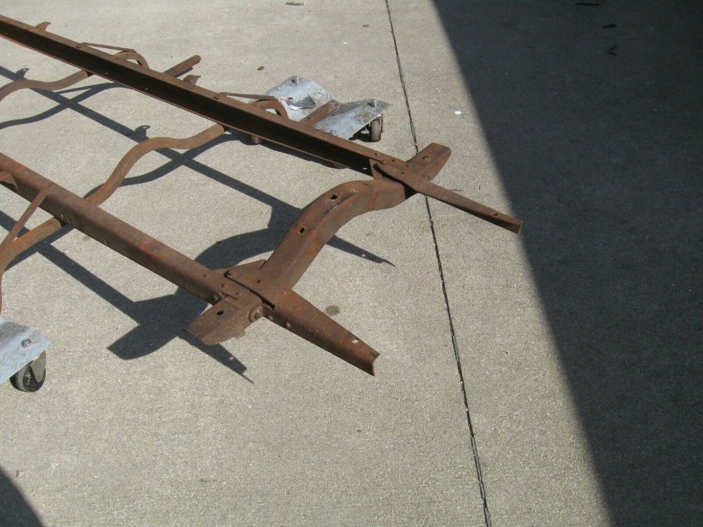

Hadn't seen these rear extensions before. Not like ones for a spare tire and I haven't been under enough T bodies

It's possible they were made for mounting a trunk on the rear.

They look like the remains of a factory spare tire carrier.

That's what I was thinking but the center photo looked different no rivets/holes on the cross member end. The far left photo looks very similar except for the holes on the top of the extender. Can't compare the length but looks almost equal to be cut

Those brackets look like they are from a early 360 deg spair tire bracket. This is odd because I see that your frame has the later type ,1921, running board bracket and the 360 spair bracket was used in 1919 into 1920.
