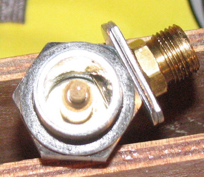

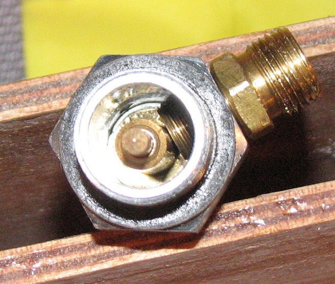

I tried the compass, and cant seem to get the needle to point directly parallel with the engine. I will remove the inspection cover and try to align the contact screw with the contacter assembly pin manually. I have "crimp on" ring connectors for the cable so that I can attache it to the contact pin. My plan is to "flash" the circuit to either the hogs head or the frame.
Question: Should the brass screw make direct contact with the pin?

- Posts: 5278
Re: Magneto Failure?
sorry, i dont understand your question about a screw & pin.
your post 7 posts above this one. I am guessing I need to split the screws evenly with the contact post in the center. Also; i have the old contact assembly that I can use to "flash" the magnets, then replace it with the new one when I am through. From what I have read; 3 or 4 arcs should suffice per magnet. Just to clarify: + to the contact pin when N is aligned; - to contact pin when S is aligned; Correct?
