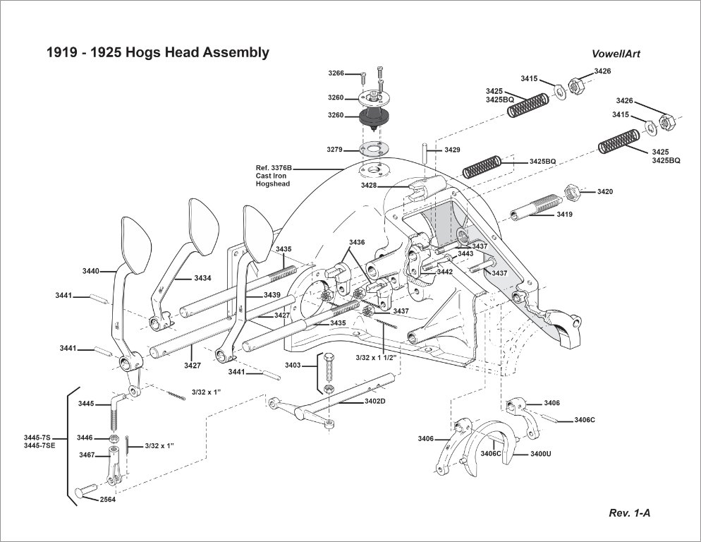

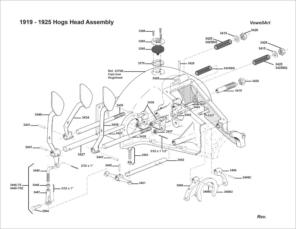

I'm pretty sure this is correct, but I thought I'd run past you guys just to make sure.

Re: ***1919-1925 Hogshead Assembly***
Not that it’s makes a lot of difference but I think Ford added a small raised ridge just under the front of the transmission cover opening. You can’t see it from the outside but only from underneath. It was supposed to help the oil go over the drums a little better. Seems like there were a few other changes here and there but hardly noticeable. Read it somewhere years ago in a history of Fords transmission covers for the Model T.
Only a real perfectionist would want to get the right cover in that era your showing. And by the way your rendition looks great as all of your drawings do! I’m sure there are more knowledgeable folks on the forum would know for sure when the ridge appeared and what year.

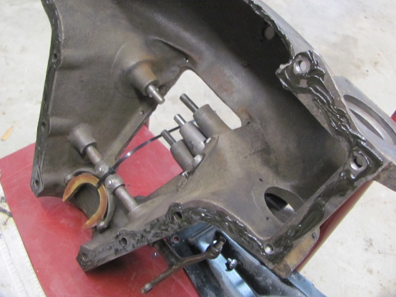

Martynn, I don't know about USA production, but on these later covers the clutch fork shaft was a one piece forging, Rather than having the cross piece riveted on.
View of later clutch release

Allan I thought something was off, but couldn't see it...it's like that sometimes, I don't see the obvious because I've been looking at it for so long...which is why I post things here, so you guys can correct my oversights.
