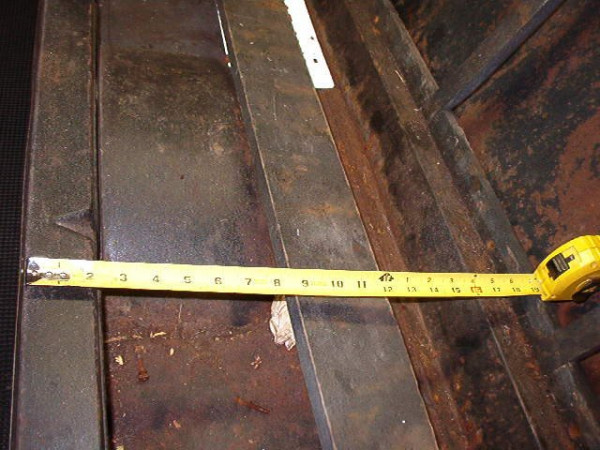

In addition to the differences other have listed, I found that the rear seat bottom cushion on 27 Canadian Touring was deeper (front to back) than the US cars and therefor the standard Cartouche upholstery for this cushion would not fit. I had to have another one made. It appears that the Canadian rear seat riser has a lip on it whereas the front of the riser on US cars comes straight up. One more comment regarding wheels on my 27. It came with wood wheels as standard and in addition to the spokes being shorter and of a different design, the rims were made by Kelsey Canada and have holes in the sides of the rims near the split to accommodate a unique rim spreader (still looking for one of those!)

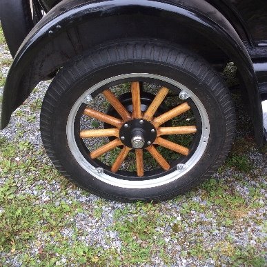

Another significant difference in Canadian wheels is in the double taper at the hub end of the spokes.There is the usual taper where the spoke narrows down at the hub. Then there is a second taper which goes from front to back. When these Kelsey made wheels are built, the spokes are fitted with the front-to-back taper alternating. This feature makes for a firmer fit at the hub, while making assembly so much easier. There is no need for a spoke press.
The previously mentioned different length spokes are simply down to the Kelsey manufacture of these. Their felloes are of slightly shallower cross section, so the spokes are a little longer.
The last of the 23" wheels used on Canadian cars did use fixed lug rims and the slightly deeper felloes used in USA production, but these still retained spokes with the double taper.

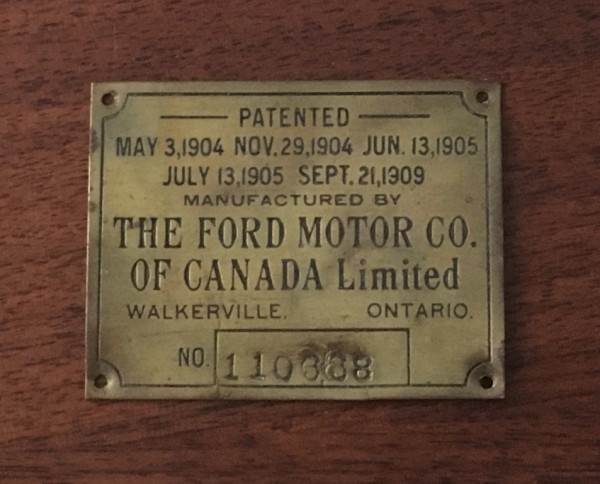

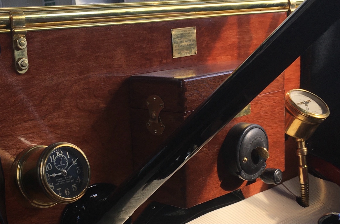

Canadian 1912 dash mounted serial number plate.
The brass plate was fastened to the dash with brass nails.
Plate location original to my 1912. Some plates were mounted higher, right against the brass dashboard trim.
The plates were centred with the coil box.

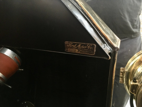

Canadian radiator plate.

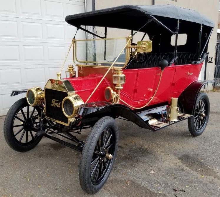

My fore-door four door.
