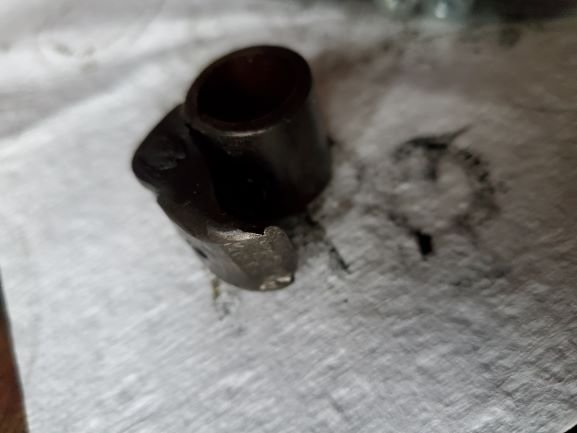

Replaced the timer last night. Here is the old flapper.... a very worn flapper for sure. Hopefully I have found the problem.
I'll check the timing, put a new set of plugs in, and fire her up this weekend

Your flapper is severely worn and you need a new timer - this is the first evidence of any problem which would be connected with your trouble now that you have confirmed good compression.
you're getting ready to put the new timer on and see how it runs. Why on earth would you start bending on a brand new timer before you have ascertained that 1, it needed it for sure, and 2, it actually is defective out of the box?
if you start bending in it as new, you have just thrown another variable into the mix.
just put it on and enjoy your car
