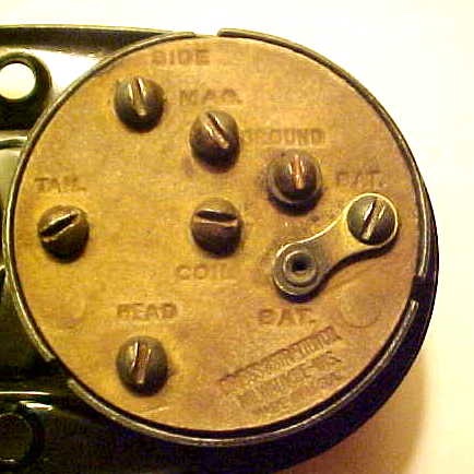

Original switch backing is a laminated cardboard like insulator, the plastic is a modern reproduction.
26671 copy.jpg (57.41 KiB) Viewed 5273 times
Backside of a Ben Martin rebuild. The original laminate wafer terminal back is repaired and then sealed in clear epoxy.

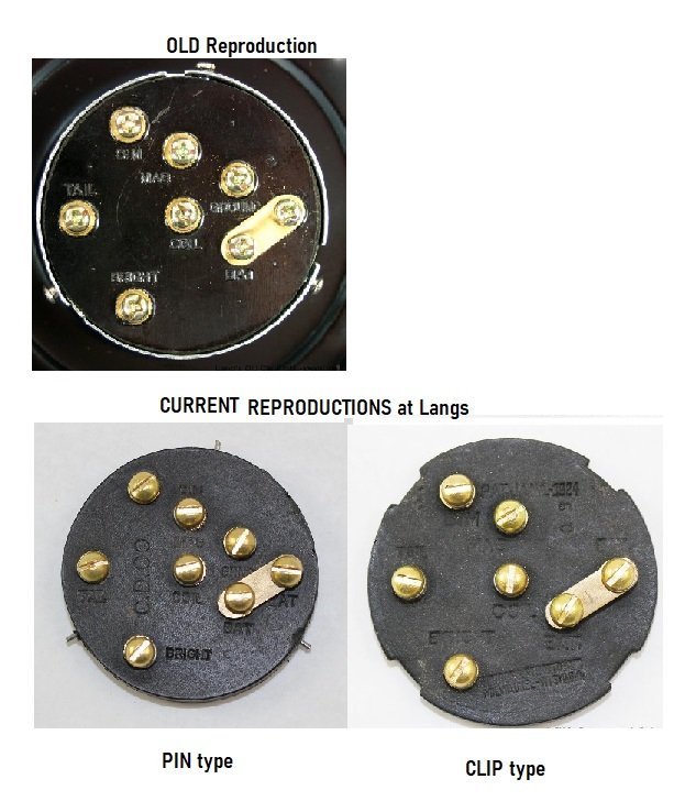

For awhile Langs was out of the switch plates there current online catalogue shows some descent looking ones versus the old phenolic back. May need to check if they have stock now

Old plastic reproduction switches would start to melt if a connection got hot. my 26 touring had one on it. first night I turned the lights on sparks flew out of the switch and it reeked of burnt plastic. replaced it with a Ben Martin switch. and installed a inline fuse holder on the hot wire coming from the starter switch at the firewall terminals.

The reproduction switch back from Lang’s is what I used for my switch. It’s works fine and is a well made piece. It’s made of some sort of black material that’s not plastic I don’t think and is pretty durable.
Ford would have used this type of material if it was available I’ll bet.
