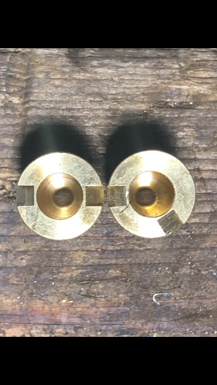

So I bought a new float needle and seat for my Holley G carburetor, but not sure what's the best way to install it. I had a deuce of a time getting the old one out with a screwdriver and hammer so I know that's not the best option for reinstallation. Is there a special tool for screwing it down? The two "slots" are angled so a normal screwdriver won't work. Any advice would be greatly appreciated!

Your statement "The two "slots" are angled " tells me the slots were cut wrong. A file will revise them for a screwdriver bit.

Um, Jack, if the slots are cut "wrong", Holley sure messed up a bunch of them from inception in 1914 through the last cast-iron bodied Gs. Every one I've ever seen is like this. The best advice is to make an adequate tool for the purpose. It's really not that difficult.

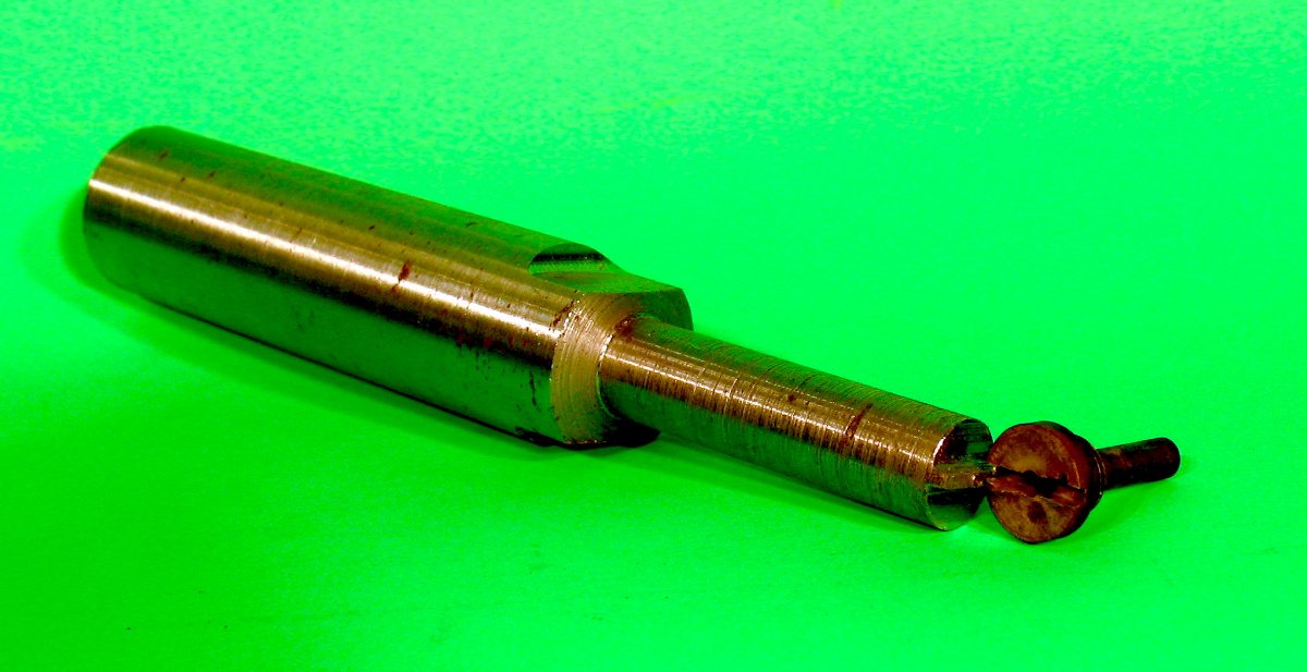

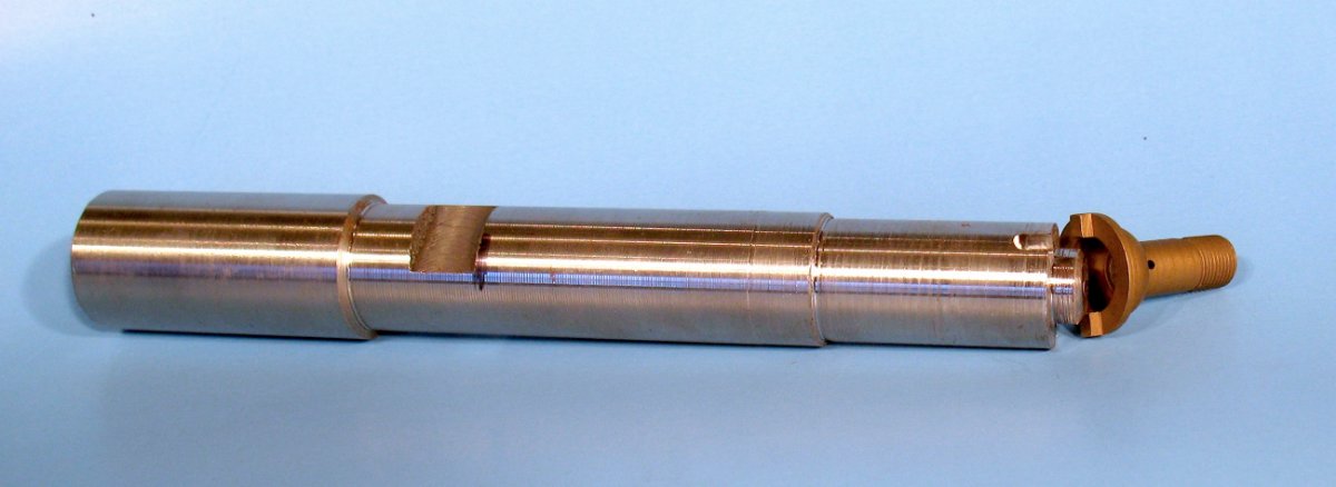

- Posts: 7330
Re: Holley G float needle seat
Several years ago I borrowed the use of a lathe and a mill at the local juco and made some carburetor tools. I used a junk axle shaft.

Now that's ingenuity!

Somebody at some time made them with a straight slot for a screwdriver. Out of all these only 3 are the ones with the 2 angled cuts. I got a new one before that was cut wrong, the slot was in the wrong place.
You can use needle nose pliers in those slots as suggested above then when it gets tight stick a punch at the outside edge of one slot and hit it with a hammer to tighten it up more. You can also grind the slot for a screwdriver as suggested above but if you do you have to get a round file and file the burrs from the inside or the needle will stick. Put it in upside down and twist it with your fingers to make sure it doesn’t bind anywhere.
