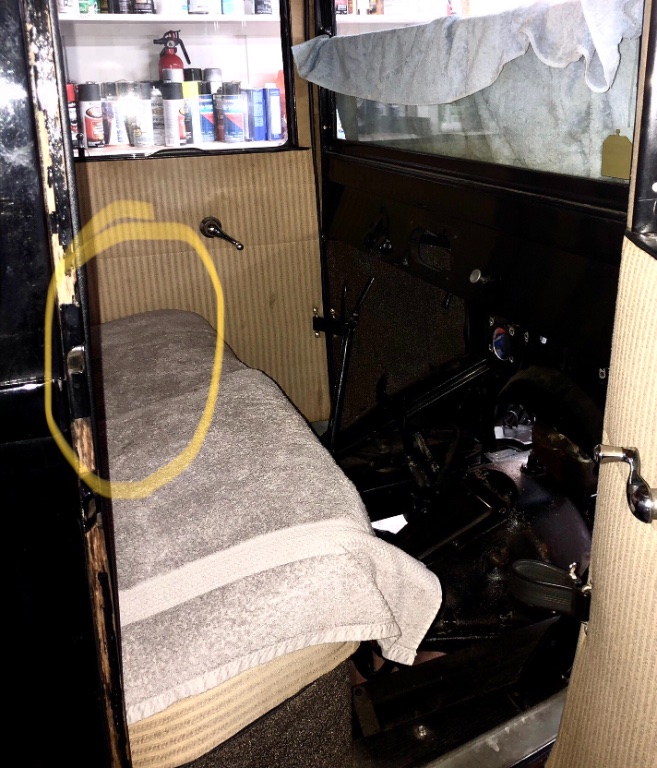

Post by DanTreace » Tue Mar 30, 2021 8:33 pm
Dick
Replaced some of those bumper on the '25 coupe last fall, got them from Lang's 6927BX, the flat top one, measure an old to be sure. The catalog says 26-27 but these fit earlier bodies too. Snyders lists the same door bumpers as for '09-'27! I did have to use a razor blade to trim , and sanded the top for clearance. Made it snug but not too tight. A bit of silicone paste on the surface makes a good lube. Prevents sticking doors.

Post by DanTreace » Tue Mar 30, 2021 9:51 pm
The wood post has metal recess socket that holds the bumper. If your car is missing those recessed brackets, Langs sells repro replacement.
Pry out the old, using a thin tool, screwdriver etc. The bumper just slips into that bracket by squeeze. Can't work loose as the door edge holds it too.
