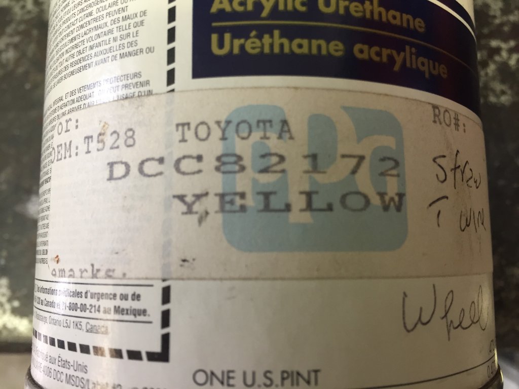

This is the paint that was recommended by the Ditzler archives when I checked several years ago
The Ditzler code is 82172
Dupont is 43334
This was used on 1974 to 1978 Toyota's as OEM paint code 528.
