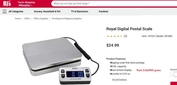

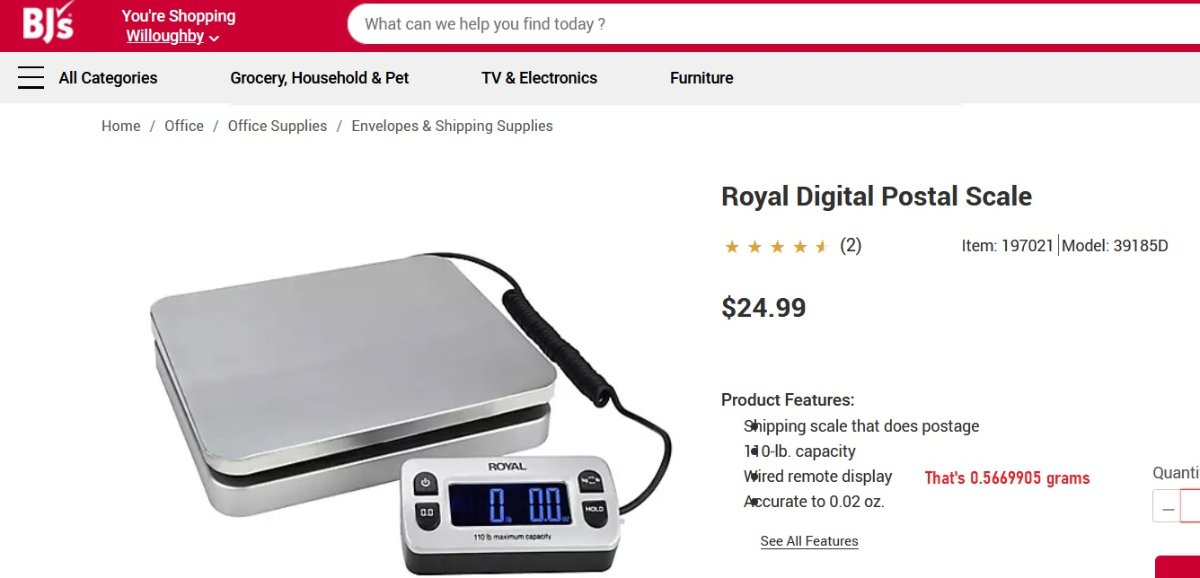

I'm not sure what you are planning to us it for and what you consider is a reasonable price. I bought a scale similar to this for about the same price delivered.. It self zero's when turned on and the separate display is very convenient when weighing items larger than the platform.
There are even less expensive scales with the same range of accuracy. I was within an ounce of a FedEx scale for a 32lbs package
