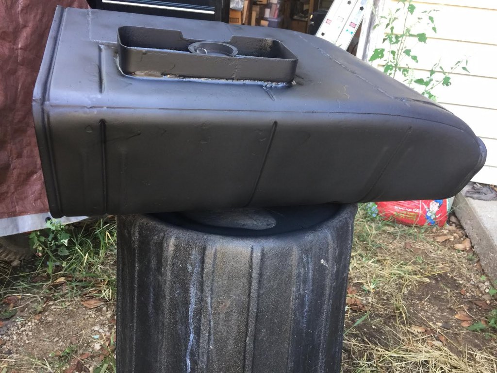

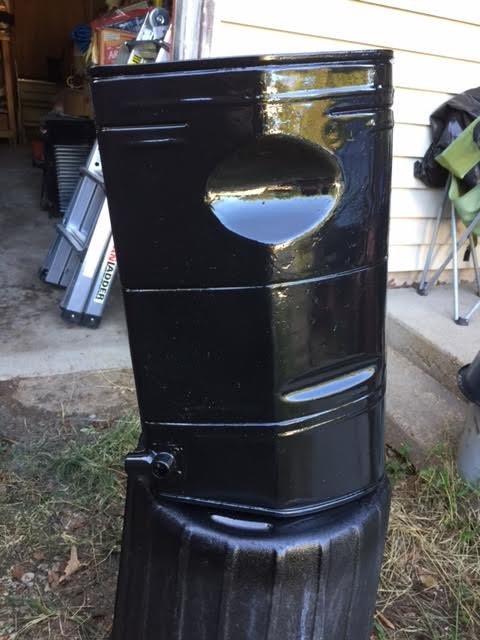

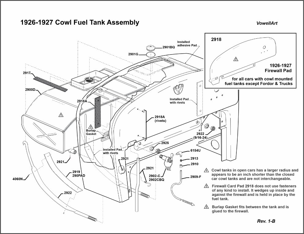

That Aluminum tank doesn't seem to be shaped right. The angle is too steep and too long so, I doubt that it fits correctly either. Which may be why it is made of aluminum (easier to mold it to fit under the dash). Wonder if it has the notch on the rectangular side for your foot brake pedal clearance?
George Clipner's fuel tank from his 26 touring.
