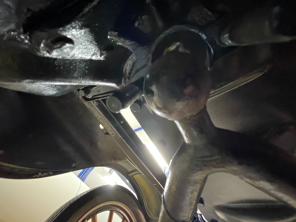

So when I went to hook up my Radious rod it didn't line up. I'm thinking that I have to jack up the frame of the car to allow the front suspension hang and line it up that way. Am I missing something?

Jack the radius rod up and pull back at same time, it'll go in.
