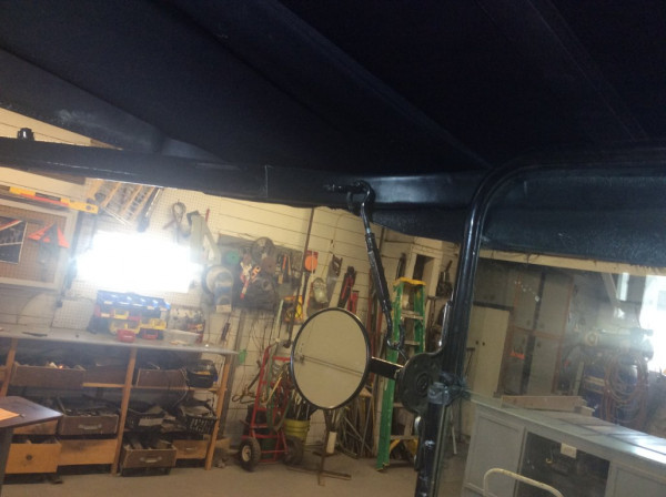

when I was installing my classtique top on my touring I had the straps from langs for the front bow. Where they were so short and stiff it was difficult to tighten them evenly. It occured to me that a turnbuckle would woould be easier to adjust. I put on the turnbuckle from the hardware store and found it worked much better and easier to adjust than the straps.
