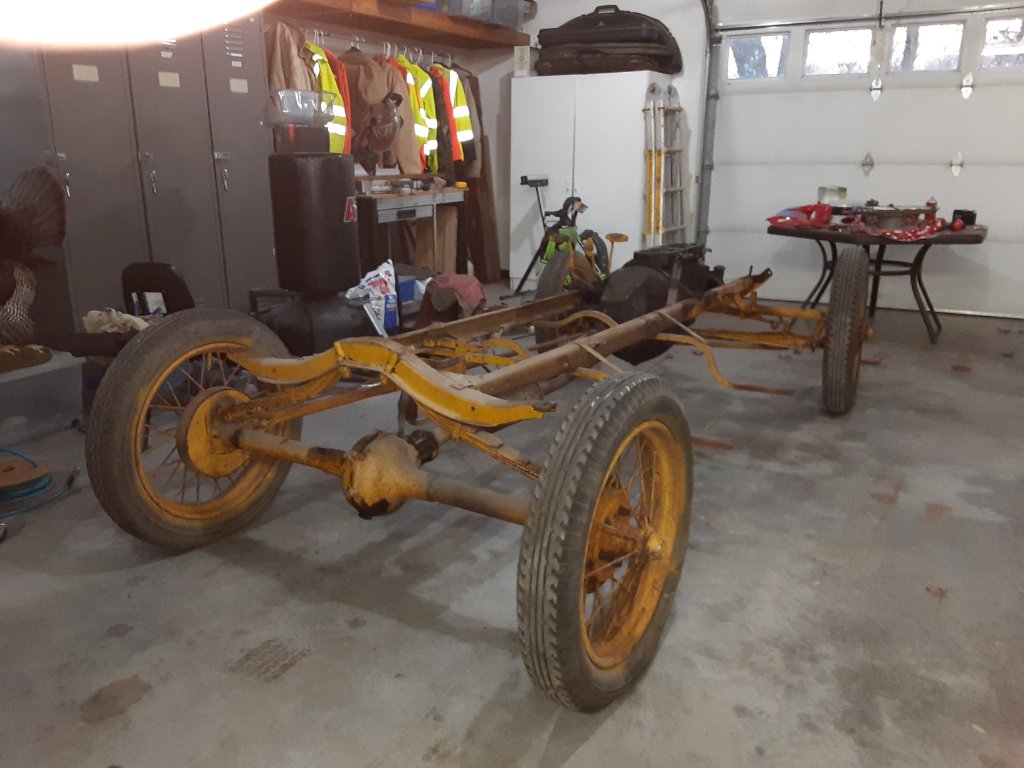

I planned to have the frame/axles/wheels blast cleaned and then brush paint them using Rust-Oleum primer and Rust-Oleum black gloss. However, I now am considering having them powder coated. I would appreciate members commenting on these two options.
