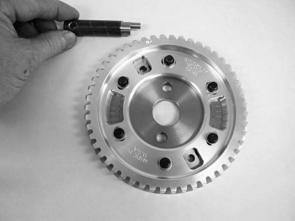

stipe 280 and adjustable timing gear, degree the engine.

What do you mean by "adjustable timing gear? It would seem to me that if the timing gear were adjustable, it would slip as you drive along and get out of time. I believe the 280 grind of the cam shaft is all the adjustment you need and can use a standard timing gear.
